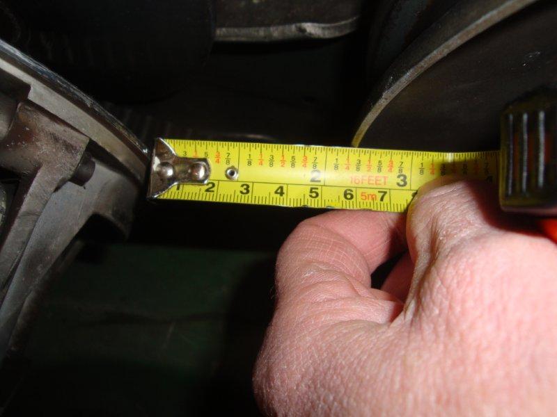

The exact measurement between the primary clutch bolt center and the secondary bolt center is 11.47 in. (just slightly under 11-1/2 inch)
newer belt replacement, this replaced the 1078 series
measurement between the primary and secondary

Thanks to all that responded. The measurement between clutch inner sheeves was a great idea, assuming you are 11.47" c/c then that measurement between clutches will be much easier to gage. BTW my mounting plate has elongated holes.

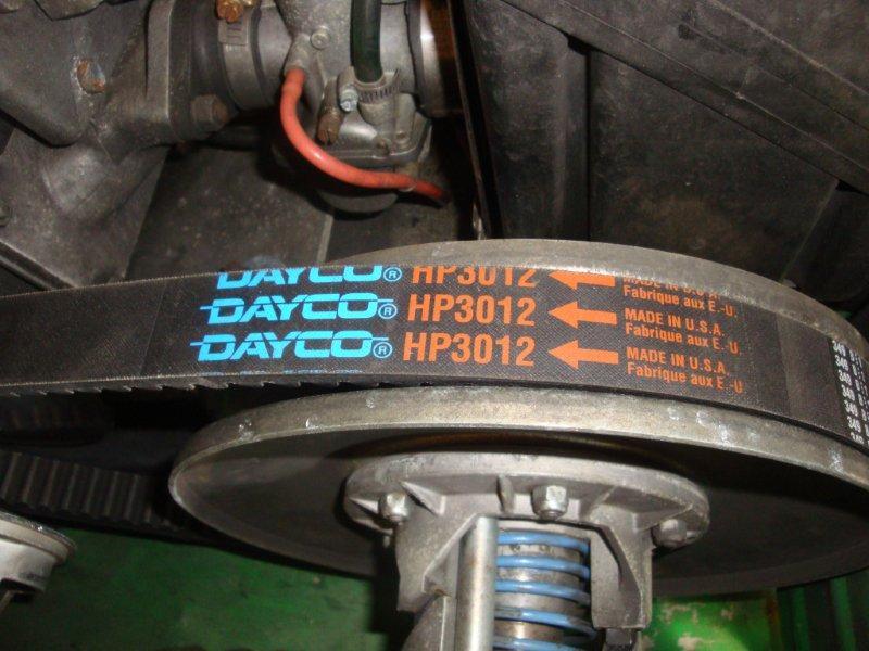

After adjusting my cluthes to proper spacing and installing my Carlise 1078 (4615/32), I started the sled. I found that when on the stand and running there is some drag on the belt causing the track to rotate slightly. I went online and the Dayco HP3012 is slightly longer @ 46.688x1.25, going to buy one and give it a try.
Funny how we celebrate the snow and curse it at the same time.

As far as belts go, I bought a Dayco HP3012 seems it fit better, no drag and it sits higher in the secondary.
