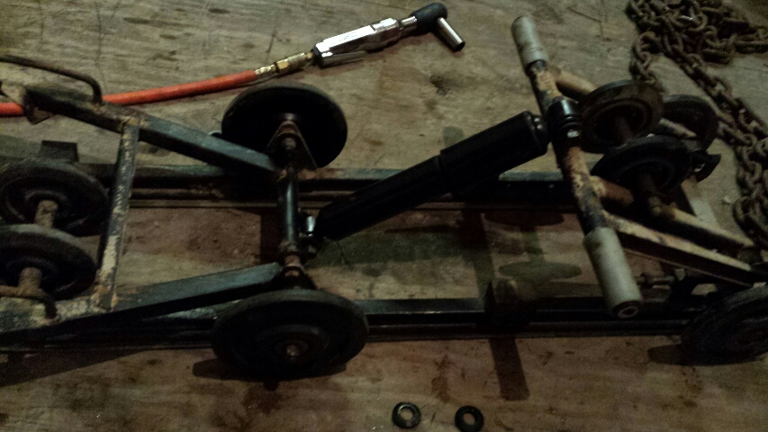

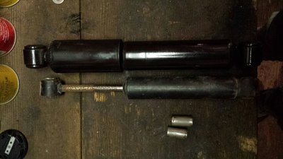

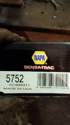

Those are hard to come by but i did find a cheap replacement gas shock last year that i used on my trailfires and 83 & 84 sportfires. Its available at napa & oreillrys for under $30 and you just need to swap the steel bushings with your old ones and i trimmed the rubber on the top mount. Its a sensa trac 5752.

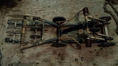

A few pics

Be careful with using a longer than stock shock. It can allow the suspension to over extend and let the top shock mount contract the track. On the rubber track sleds like the 82-84 Sport and 80-84 Liquifire, it can tear out the center row of drive lugs.

Hey guys Joe is right. The longer shock will tear up the center drive lugs also it would allow the suspension to over extent causing the rear springs to pull off of their perch and possibly cause major damage. This question has come up several times in the past. I know some guys are getting gas shocks built, but I for 1 am never going to drop 3 bills for a custom shock.

You could put a limiter strap on the rear arm to prevent overtravel.

I put quite a few miles on 3 of my sleds with those shocks with no problems. Granted I wasn't ramping off of the ground but I did go through a wide variety of terrain. There is no way the springs are coming off with these shocks and I'm almost positive they don't allow the upper shock mount to contact the track HOWEVER I'm going to check my 83 sportfire when I get home and allow the suspension to max out and check the clearance. I'm be home on Saturday and will report back to you. I believe they're a great replacement when there doesn't seem to be any others available for less than $90 anywhere else
