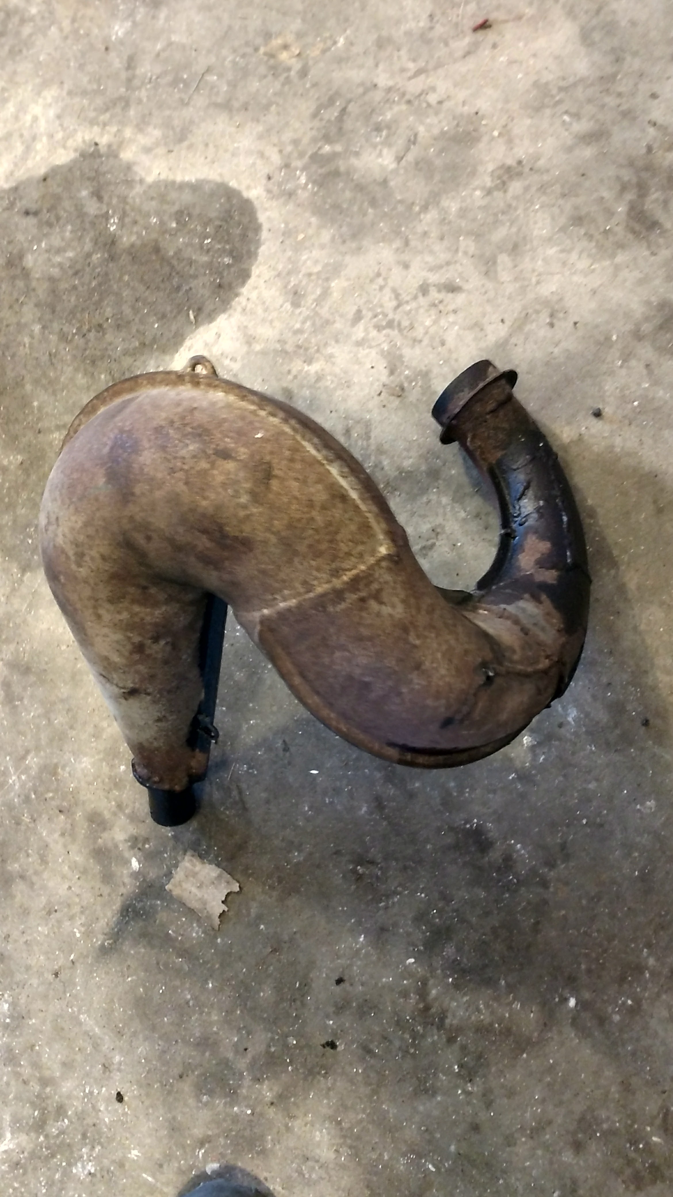

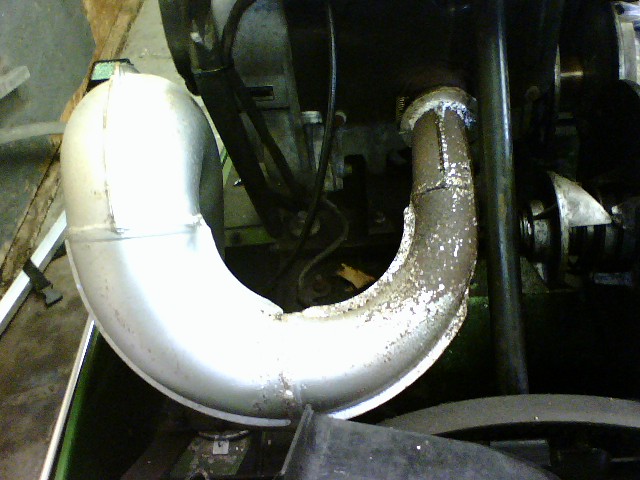

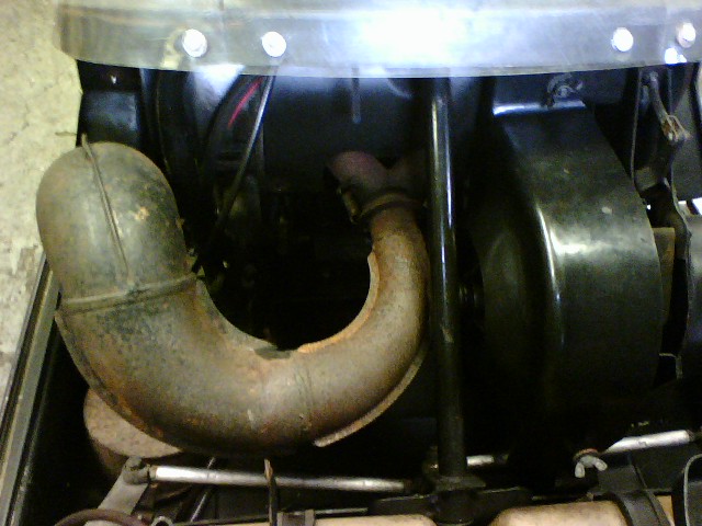

I'm looking for any information about the tuned pipes on the JDX-8, 800 and 295/s. I Know the 295/s pipe was different but not sure how. I have 2 pipes one from my parts 800 and the one on my 800. One is silver the other was black at one time. The black one has an indent the support bar and the silver one dose not. the sliver one has been repair in the past, it also doesn't have the ball style joint to connect to the muffler. Any thought?

Black pipe
Black pipe
silver pipe
silver pipe

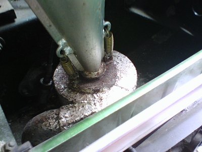

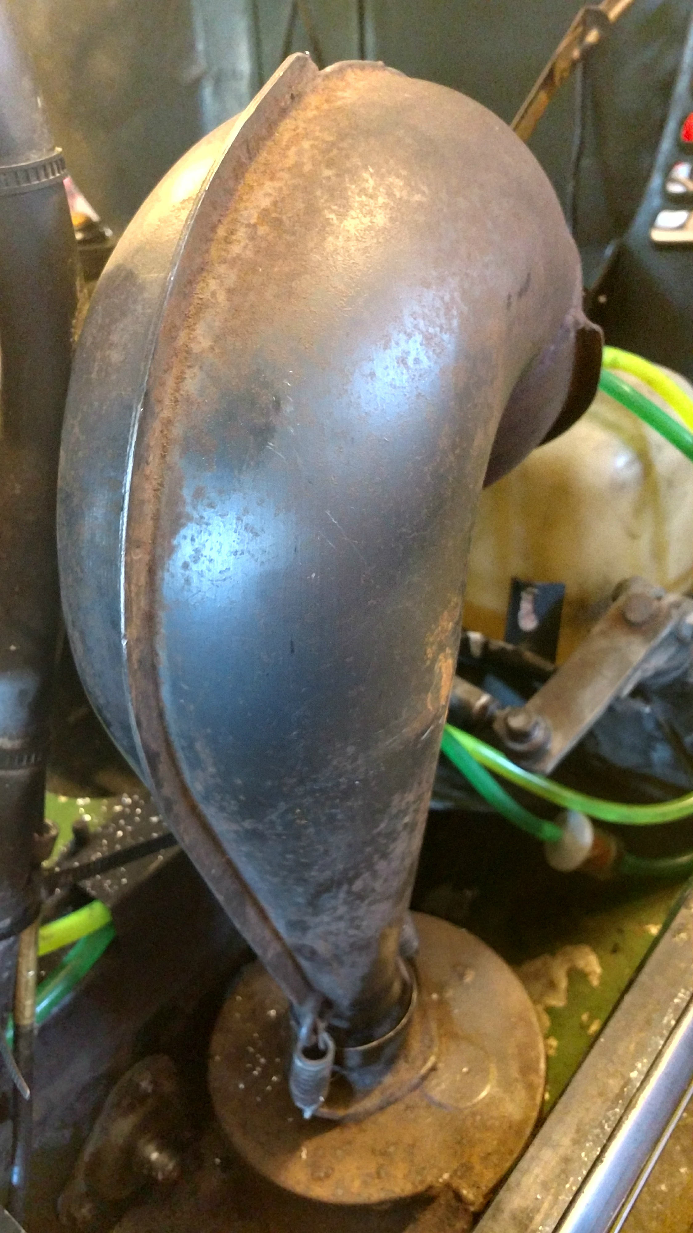

The one with the ball joint is JDX8/800, the silver one without it is 295/S. See photos

Re: Tuned Pipe JDX-8, 800 and 295/s
The shape is different. If you look at your 295/S pipe or my photos you can see where it has a piece welded up by the manifold that has a harder turn (maybe making it longer?), where the JDX8 does not have that.
