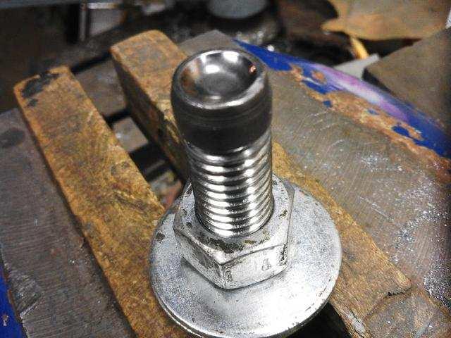

The bolt I have been using for the last ten years or so to support the rivet heads when setting the shop side, had gotten pounded pretty much flat.
I picked up a hardened tool to fix this. This is a replacement part for a tool called a rivet squeezer. I bought this off ebay for less than $7.
I squared up the end of my bolt, then drilled a 3/16" hole down the center. I had to open up the hole with a 1/4 drill at the very top to accommodate the fillet at the head of the rivet set. A little yamabond on the shank, and after that sets. it should be good to go.
