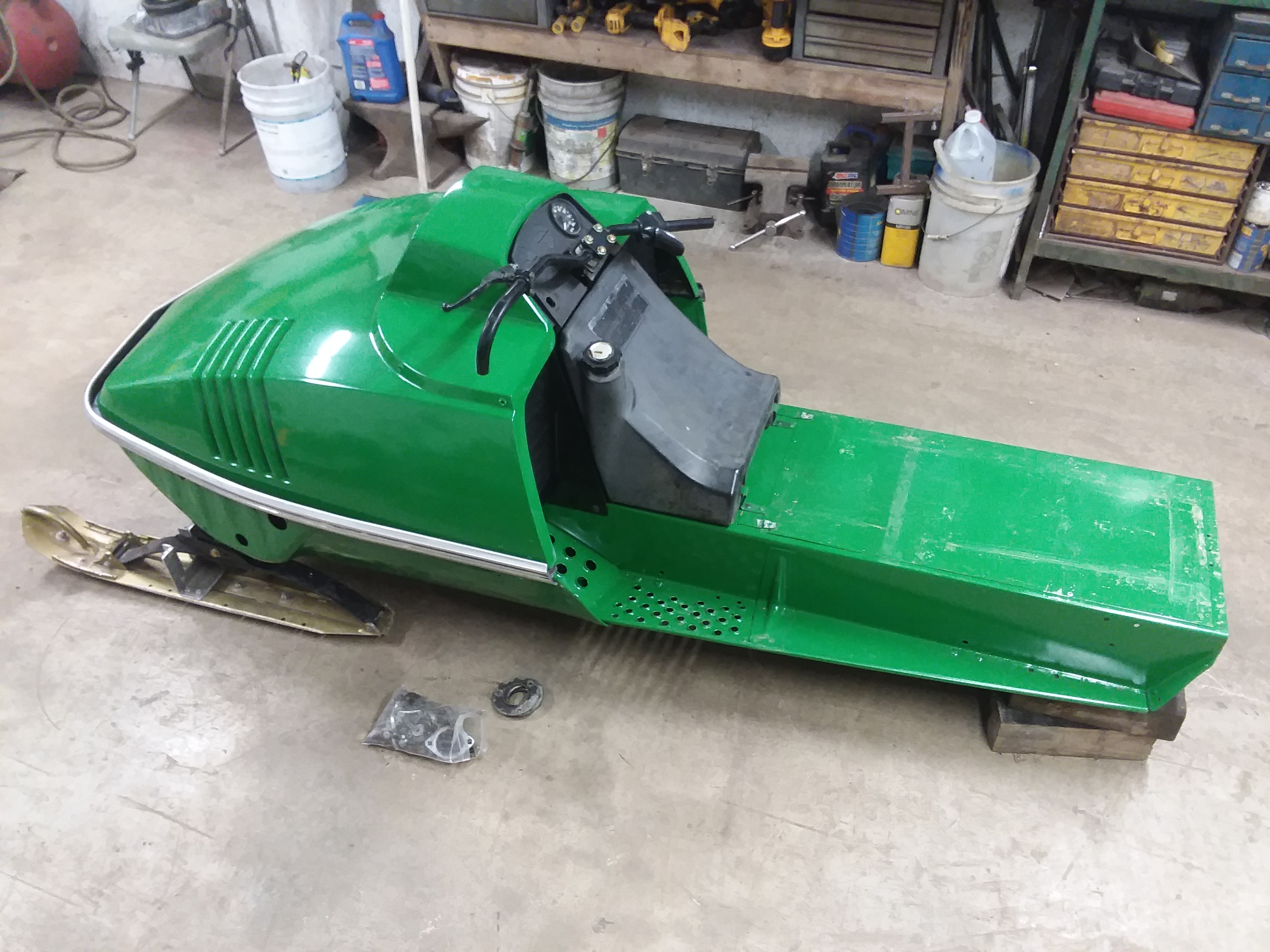

Cyclone oval racer
Wanted to share a couple pictures of a cyclone I've been building from a liquifire chassis to run on the snow ovals

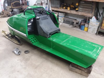

Re: Cyclone oval racer
Made some more progress today got the steering all in jackshaft and drive axle in

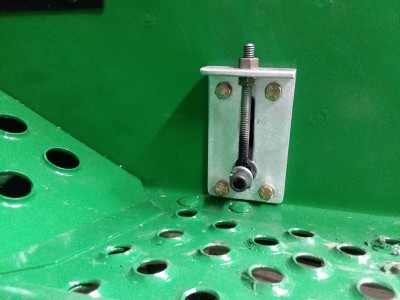

the track i am using is out of a 94 jag 15x121x2.52, i had to remove the center idler and move the drivers inward, its been a pretty straight forward swap,ended up bolting in later 80's indy 6' travle rear skid, other then making four 1/8" cross shaft" spacers i didnt have to redrill any mounting holes , but i did build some front arm adjusters that allow me to move the front of the skid 3' up from the stock front hole location
