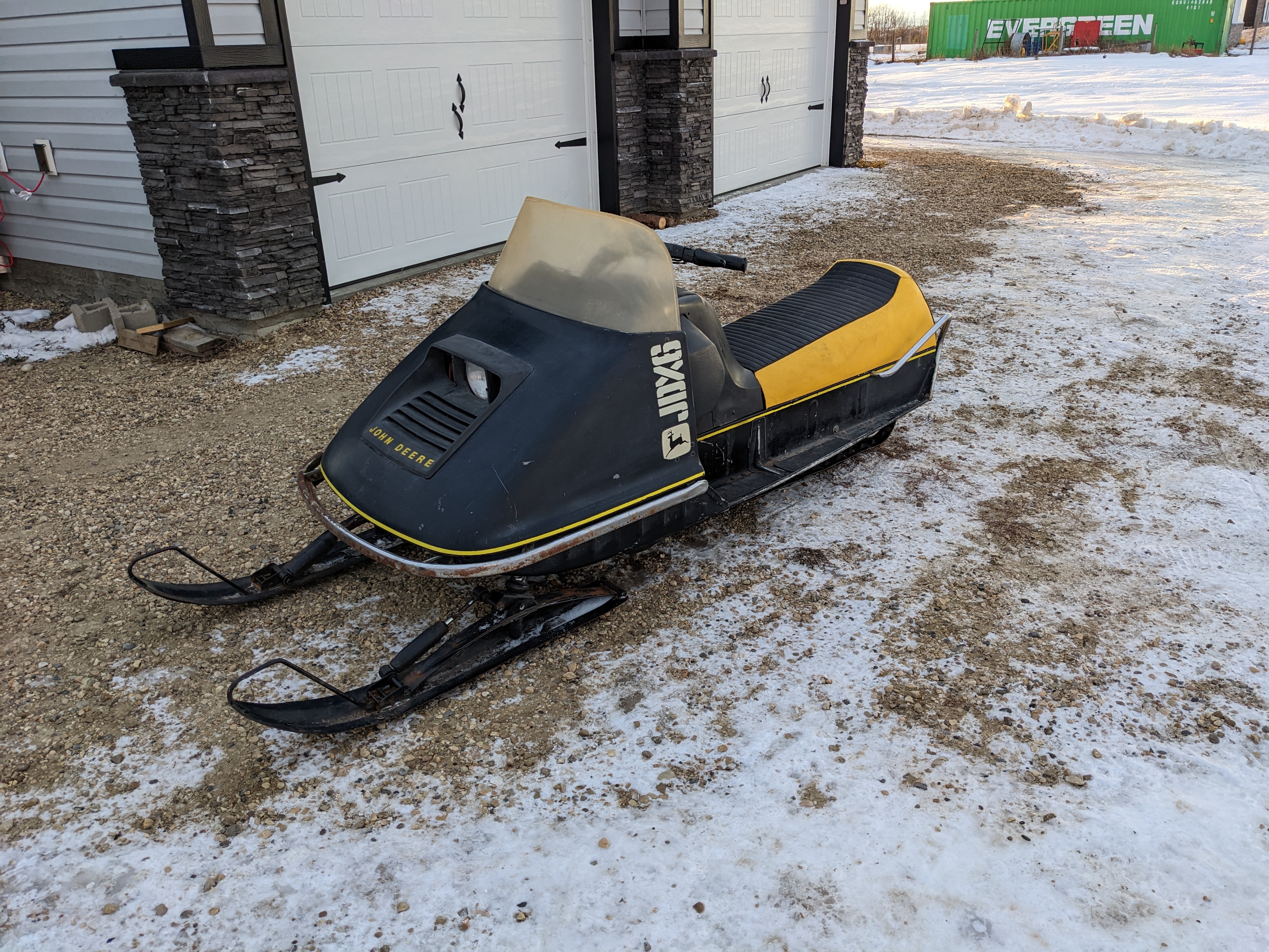

Hi everyone, just traded a 70s lawn tractor for a '74 JDX6. It has all the wiring to run electric start, it's just missing the battery and starter motor.
My question is this: does the AM52454 starter interchange to the AM52455 starter? I can't seem to find any listings for the AM52454 starter that is specified, but lots for the AM52455. The AM52455 says it's for the Kohler engine, doesn't say if it will fit the CCW/KEC engine that I can see.
Additionally, the parts diagram shows a "spacer" between the starter and the housing, does anyone know how thick it is? Is it just a gasket?
It starts pretty good 4-5 pulls when stone cold, but I'd like for my girls to be able to just go up to it and turn the key and go.
Thanks in advance!
