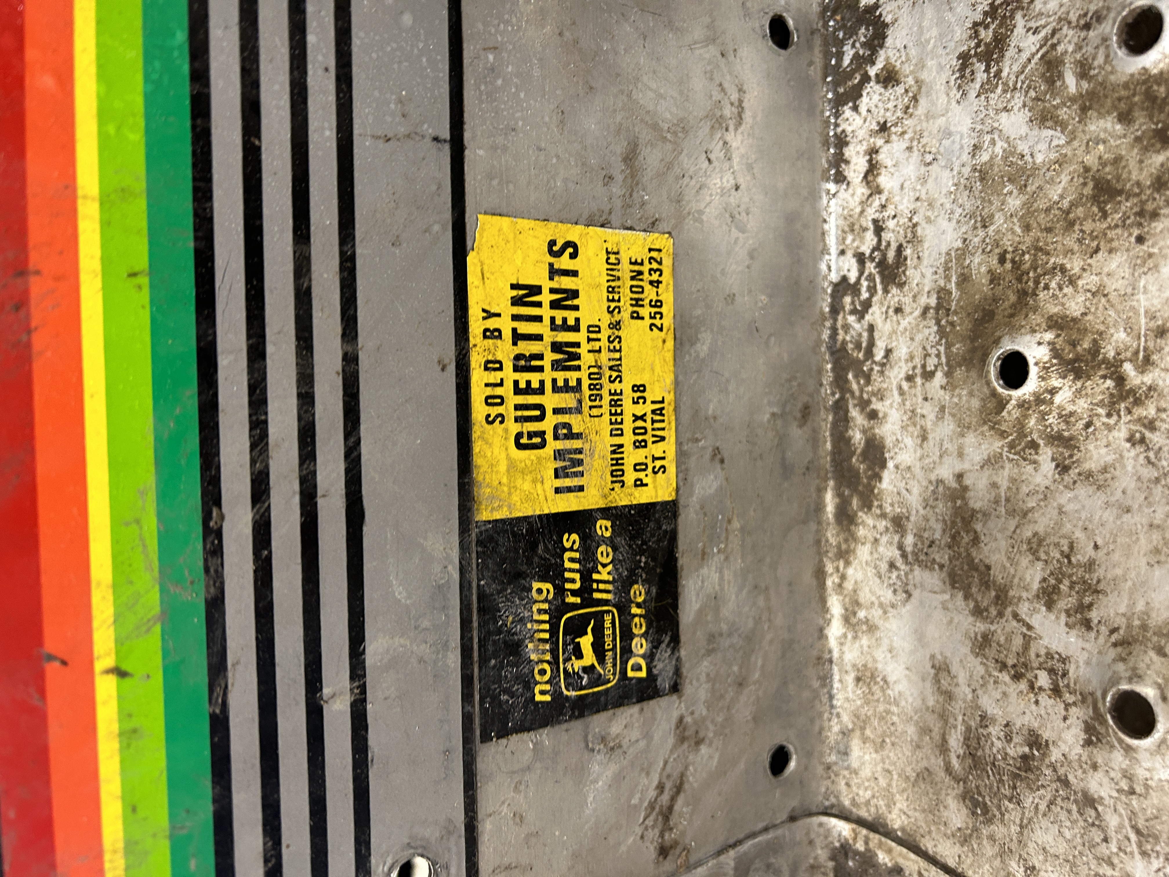

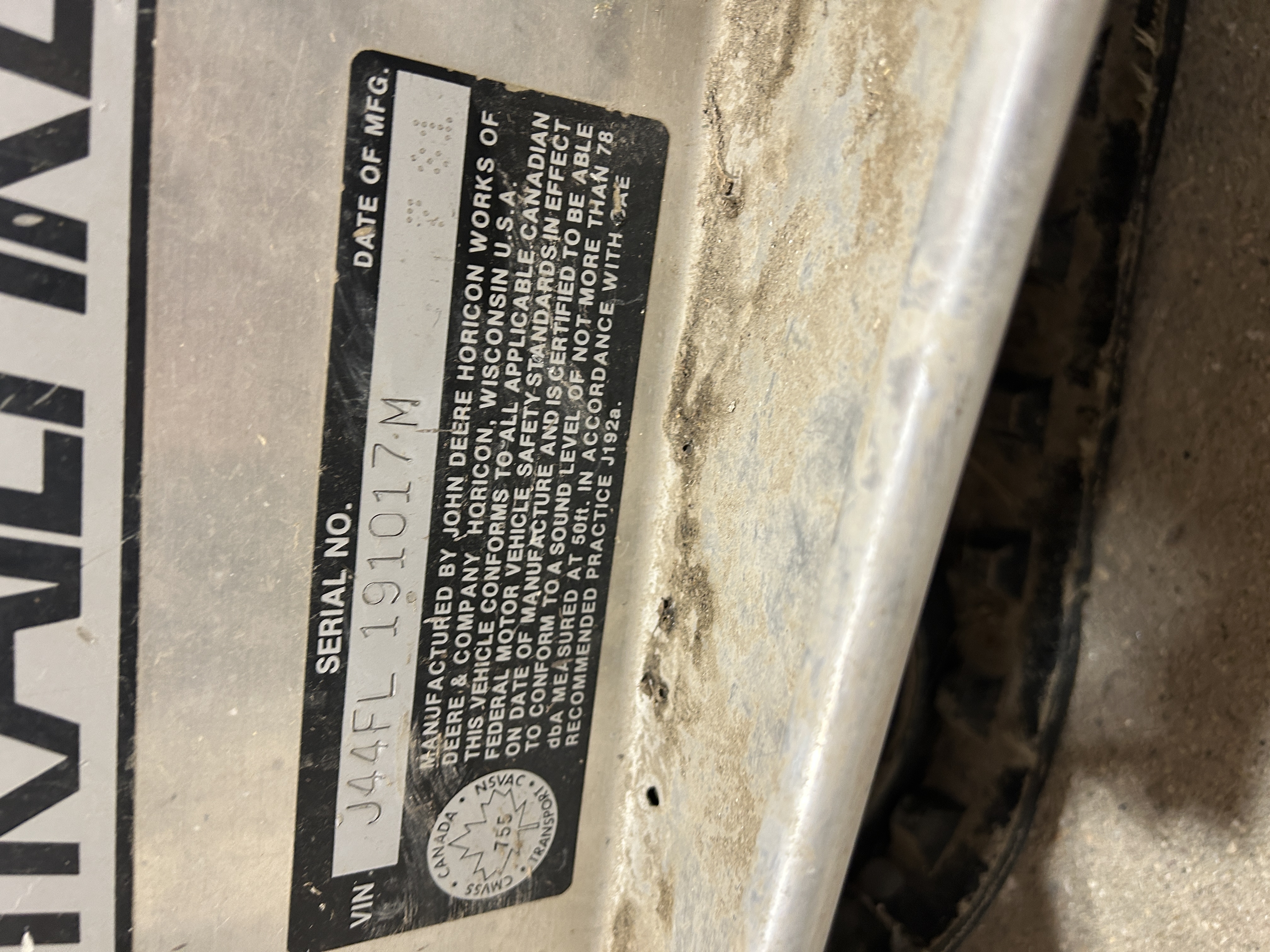

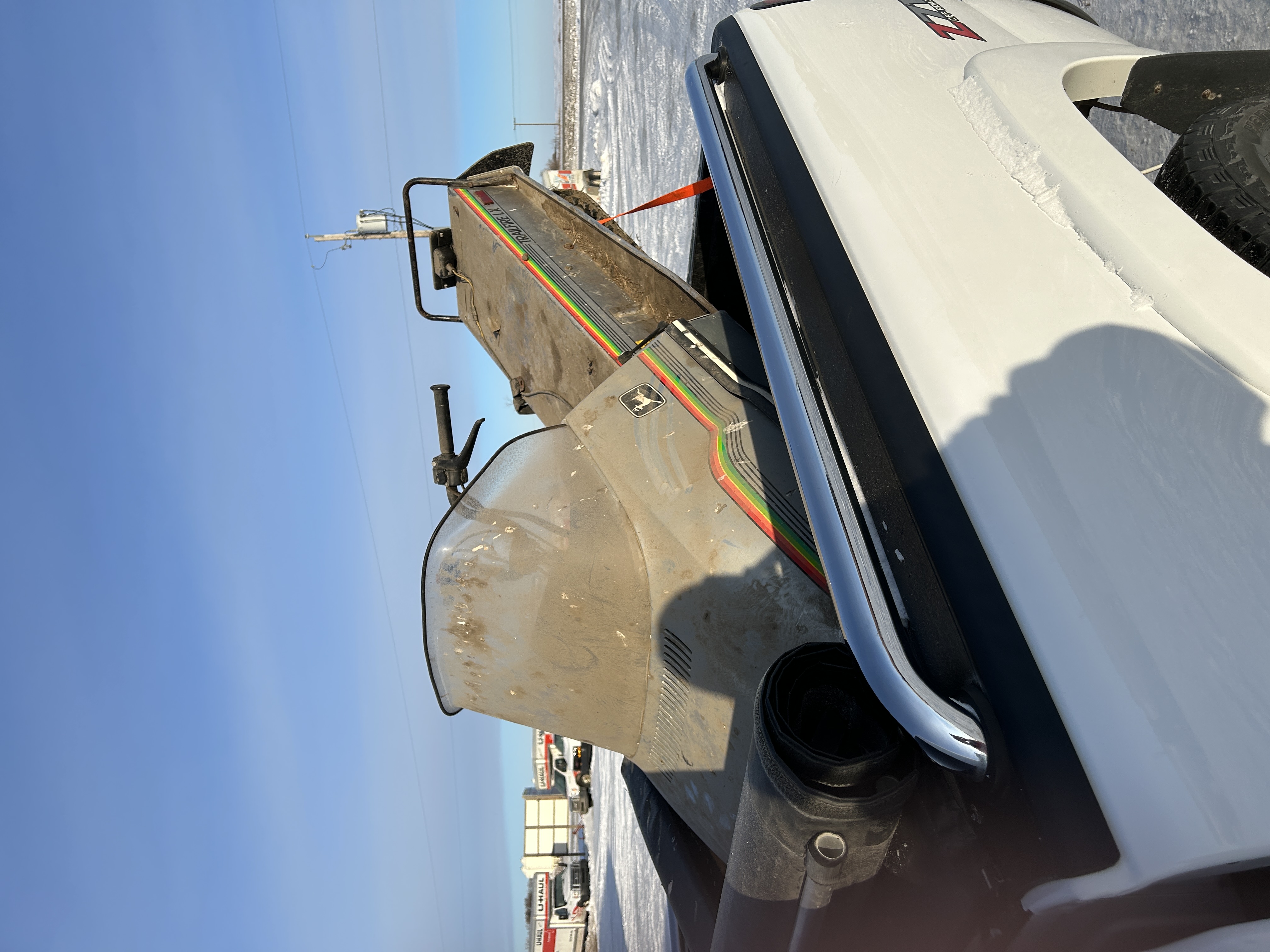

While looking for engine parts for my 400 I came across a I “think” 1982 Trailfire 440 (build date says Jul 81).
Looks to be pretty original - story goes an old man had it since new and it quit running on him / sat in a barn forever. Old guy couldn’t get it running after it sat and sold it to the second owner where it sat in a shed for 5 years again with nothing done to it.
Four hour drive later I got it off that guy for $350. Not sure what I’ll do with it yet - may over the summer try and get it resealed/cleaned up.
Air box and a few things are off and I’m sure there is some missing pieces.(seat was recovered and was just off of the sled)

Re: New Trailfire Project
That's a 1982. Looks pretty straight.
