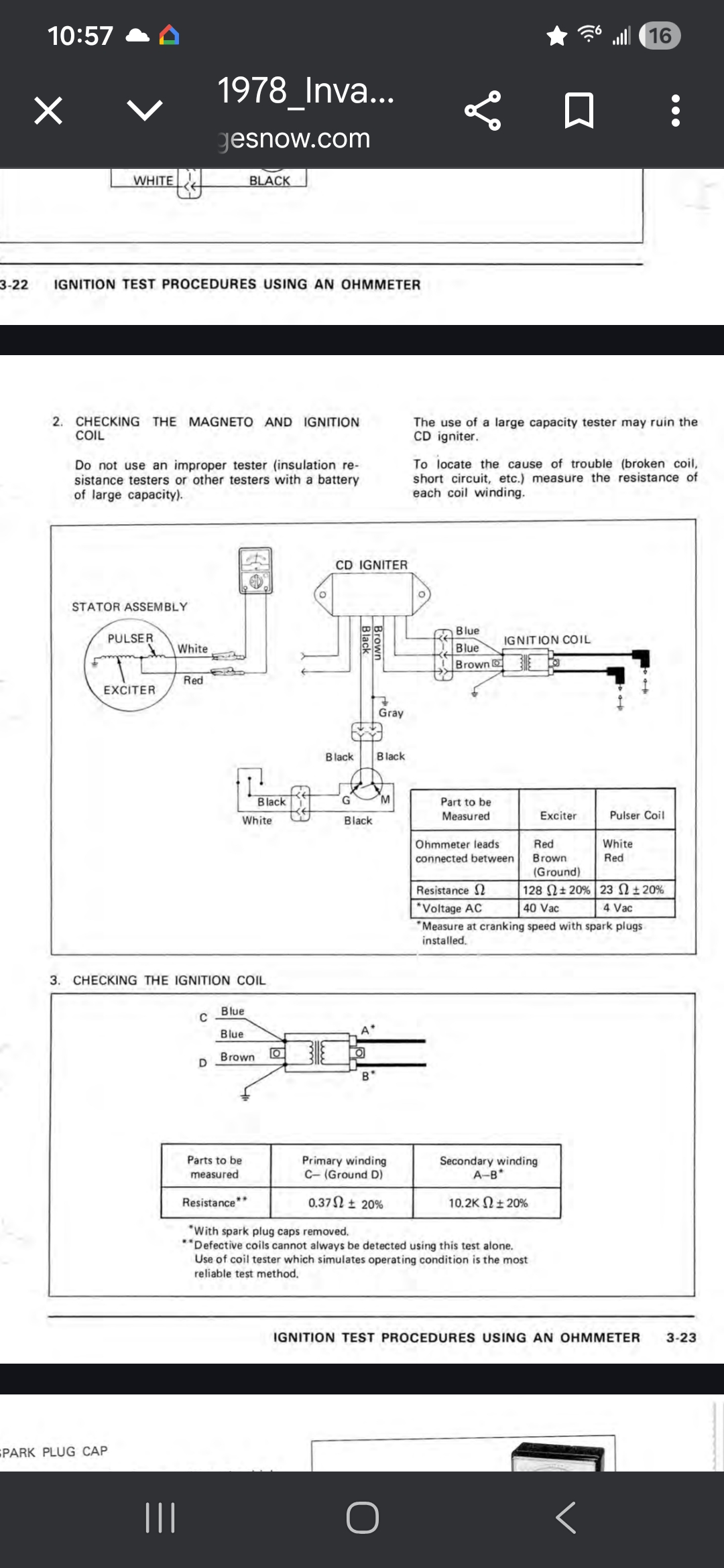

The best place to start is by unplugging the wiring harness from the motor. Then check to see if you have spark.
Unfortunately the Deere service manual only talks about testing these with a special test box. The Kawasaki Invader manual gives a little more detail. About all you can do is check the resistance of the exciter, pulse coils, and ignition coil. If those check out good, then you assume the CDI is the issue.
Here's the page from the Kawasaki Invader manual that talks about checking resistance. If you are not aware you can download both the Kawasaki Invader and Liquifire service manuals from a website called vintagesnow.
