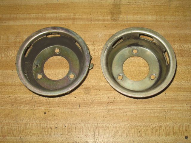

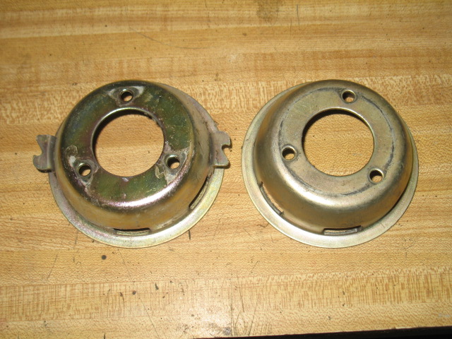

Here is a couple of pics to show the difference. The one on the left is from a Sportfire, the one on the right is from a 1980 Invader 4/6. Everything is the same except the Sportfire has the tabs on the side. I'm assuming the tabs can be used to wrap a rope around to start the engine, if the recoil goes out, but I am not sure on that. Hope this helps.

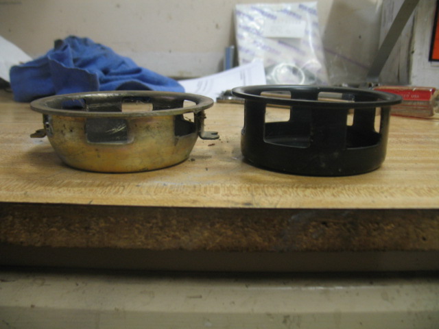

Re: Liquifire recoil cup?
There seems to be a difference in the Sportfire with oil injection also. I took a pic of one from an 82 Sportfire with oil injection, it is on the right. The one on the left is from a Sportfire engine with out oil injection. That should make it as clear as mud now.
Terre
Looks like the best bet would be to compair the two side by side as you have in the photo.
The ones on ebay have the tabs on them. I think they will fit... I am going to buy one. Thanks for the help. I will report back if they fit or not.
- Deere Daze
- Posts: 312
- Location: ONTARIO , CANADA
It will fit and work fine, only diff is that it has the tab for the recoil rope for the tool kit rope.
