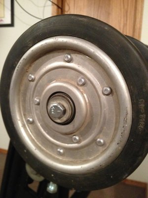

Time for a bit of an update.
Honing cylinders
Driveshaft
Assembled skid
Rebuilt idler wheels
Honing cylinders
Driveshaft
Assembled skid

Re: 1976 340 Cyclone Restoration
Very nice!
I'm happy to see someone can re-build their own Idlers ( note to Rainville ).
Question; on the drive sprockets, did you press brass collars onto them, what am I seeing?
You are getting there!
Thanks for the compliment, although I would have liked to ride it this year, haha- maybe December?
As for the drivers, they came with the reinforcing bands around them (although I had to drill through that, I also had to bore the hex out to fit the driveshaft), I wanted the ones that looked closer to the NOS ones but they were unavailable to me. These ones were the right diameter and pitch.

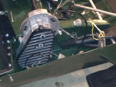

Is there a reason you have the bolts in the driveshaft bearing flanges oriented with the nuts inside the tunnel?
The reason I ask is that if you ever needed to pull the speedo drive off, it might be easier if all you had to do was turn the nuts off, pull it, and leave the bolts and bearings undisturbed. also, with the suspension installed, its going to be tough to get at those nuts.
If I'm all wet, tell me so.
400brian wrote:Is there a reason you have the bolts in the driveshaft bearing flanges oriented with the nuts inside the tunnel?
You raise a solid point Brian. Honestly, I cannot remember the exact reason I orientated the bolts like that; maybe it's because I'm following the parts/service manuals religiously, maybe I couldn't get the bolts in there with the driver in the way. I know for sure on the chaincase side it was to keep from the possibility of losing nuts and washers in the case.
Maybe next time I take it apart I will heed your advice. Sigh.
You are correct, the parts book does show the bolts pointed that direction, on both the Cyclone and the 00/JDXs.
However, the photos in the service manual show the 00/JDX speedo drive with the bolts on the inside pointing out, and that is how I remember them being on my sleds. On the 00/JDX chaincase, the nuts are welded in , so there is no confusion there. I don't have a Cyclone/ LF manual handy to look at, so I can't say for sure about that.
I do remember a thread a few years back, where a guy was struggling to install his driveshaft bearing bolts. Trying to get everything lined up, bolts inserted, them trying to start the nuts. I suggested he install the bolts from the inside, and the next day he reported that doing that had made it go a lot better.
No big deal, not trying to nit pick your work, you are doing great.
