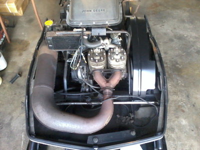

having some trouble getting the top coolant pipe off. bolts are not cooperating, er at least one isnt! it turns a little, and then feels like it could twist off
going sandblast the exhaust, and repaint.

Got the exhaust repainted with CAT Hi-Temp muffler paint...pics to come soon
Also, got the lower collant pipe blasted clean, and sprayed in a clear laquer. I will get pics of that too.

if you painted clear on aluminum that gets hot you may hate it, we did this on a motorcycle engine and the stuff turned brown and flaked off in little pieces, looked like it had a sun burn that was peeling...........

I will keep that in mind. I guess, worst case scenario....I have to re blast those parts.Danzig wrote:if you painted clear on aluminum that gets hot you may hate it, we did this on a motorcycle engine and the stuff turned brown and flaked off in little pieces, looked like it had a sun burn that was peeling...........
