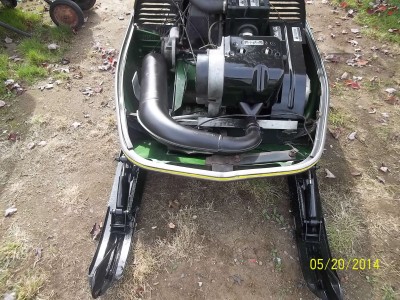

exhaust repainted, ski's repainted. pan cleaned out, steering torn down and greesed up put together, fresh seals, engine cover repainted. now gotta put her back together

pics
Posts: 2969
Real Name: Pat Scott
Location: Southeast Pa.
Re: 1976 john deere cyclone
Post by harleysportster »
Looking good, don't forget all the mounting hardware for the shroud and exhaust pipe.

ya that's all on now I shot pics to soon.lol
