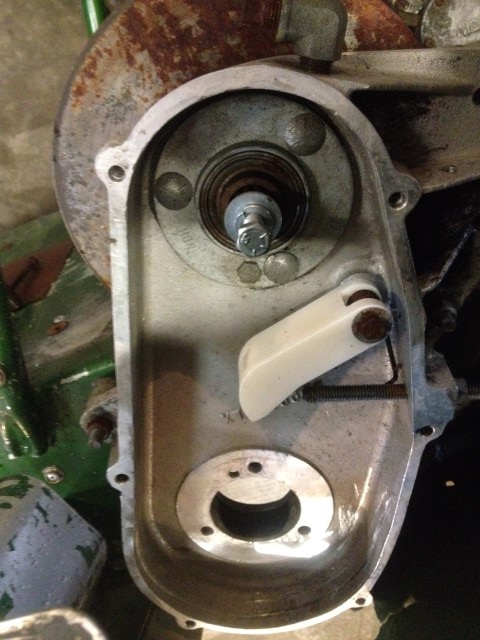

I noticed a couple more peculiar things on the 340S today. Was it a requirement for cross country racing to have the snow flap enclosed on the sides. Also there is a 4th bolt in the flangettes in the chain case. Was the extra hole in it from new or was it drilled in later & what would be the purpose of it ? Does anyone have a list of upgrade recommendations published by JD to prepare the machine for cross country racing ?
