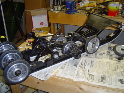

My suspension; the nose wheels aren't installed in this photo, looks like one is laying there on the bench.

Suspension on the right is a Liquidator heavy suspension.
Re: Barn find
340sracer wrote:Thought I had a spare suspension for the 340S, the rusty one on the left is the one that came back with the sled. The one on the right I found in a shed, but the front arm is shorter & it has a single shock so am not sure it will fit the 340S. The one on the right can have 4 wheels attached on each side of the slides, which I thought we ran in the cross-country races because of marginal snow in places.
The one on the right is not a 340/S suspension.
