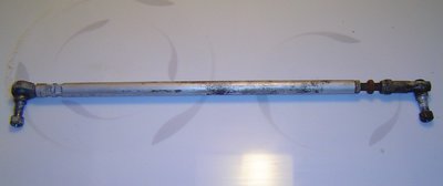

Need tie rods and ball joints for 340s, any ideas where I can get them from?
thanks Glen

Glen,
The ball joints are called Heim Joints. I think I bought mine through McMaster-Carr. If you have a local bearing supply house near by they would probably carry them or could get them for you.

Re: Barn find
Glen; its easy, you just make up a new set!
Go here: http://www.jdsleds.com/community/viewto ... ods#p44831
Troy and I re-built a pair of 340/S' a few years back, and we documented most all of it here on the list, you just have to find it.
The problem in making them was that we didn't have the ability to cut left hand threads. So, we tapped the aluminum rod right hand on both ends, put a male rod end on the steering shaft end, screwed the adjuster into the outer end, and put a left hand thread female rod end on the end of that.
Then after all that, we looked at the 340/S that Ed Kruel had at the time ( which was a JD team practice sled ) and saw that they had made them up out of steel tube.

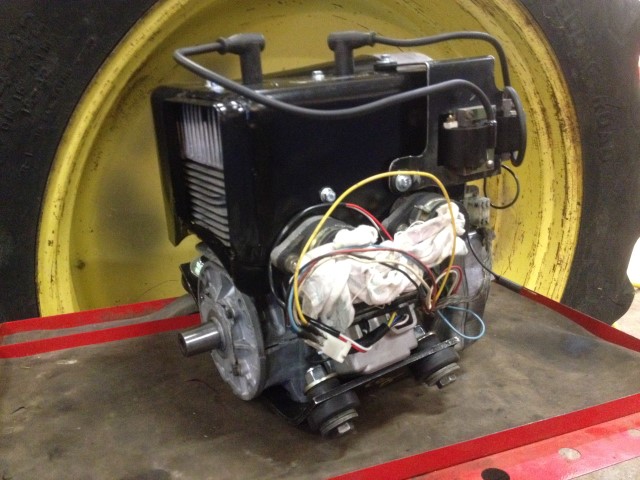

Here is an update on the restoration.
I want to thank Ryan Baird from Ontario for sending me a twist-grip kit so I can get the throttle cables copied.
If that doesn't work, he said I could use them for the time being. :clap:
Attaching a couple pictures. The motor is ready to drop in & the running gear is now installed.
