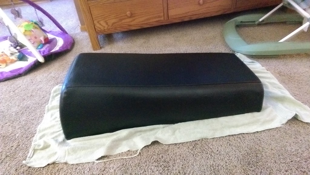

As usual progress is really slow, but here's the latest.
Santa was very good to Larry this year. I only wish he would bring me sled parts for Christmas
. My wife was in charge of taking the photos Christmas morning, and for some reason she normally takes a few hundred. This year there were about 15......go figure.
Evidently Santa and John's Upholstery must have some sort of working relationship. Larry had a nice seat cover under the tree, so that was this weeks project.
Here's a few photos of the bottom side of original seat.
So Larry started by carefully cutting as much of the old cover off as he could. Then he finally got to try out the new heat gun. We have to thank JDT for mentioning the deal at Menards. Fortunately my sister-in-law loves doing the black Friday thing so we had her pick this up.
The heat gun made quick work of removing the old vinyl that was glued to the seat. Now if I could only find out exactly what glue they used. 3M Super 77 doesn't seem to hold well for me. The last "sport seat" I recovered I actually resorted to contact cement for Formica, which was better but still has a tendency to come loose when it's warm.
I didn't do a very good job myself of taking photos while we worked on the seat. Larry started by cutting new plywood (it was his first time using the jig saw). He then drilled the holes for the new stainless T nuts and drove them home. The next day we steamed the foam. I was a little concerned, the old cover had shrunk so much that the foam was about 1-1/2" away from the tank with the old cover removed. I really wish I would have taken a video of this process. Larry was amazed how much the front of the seat foam expanded when we steamed it (I was also). After letting the foam dry over night we installed the seat cover with monel staples.
Anyway here's the finished seat.
We had to take it out and test fit it to the sled once complete. I think it turned out pretty good for a bunch of rookies (well this is the third seat cover I've installed).
