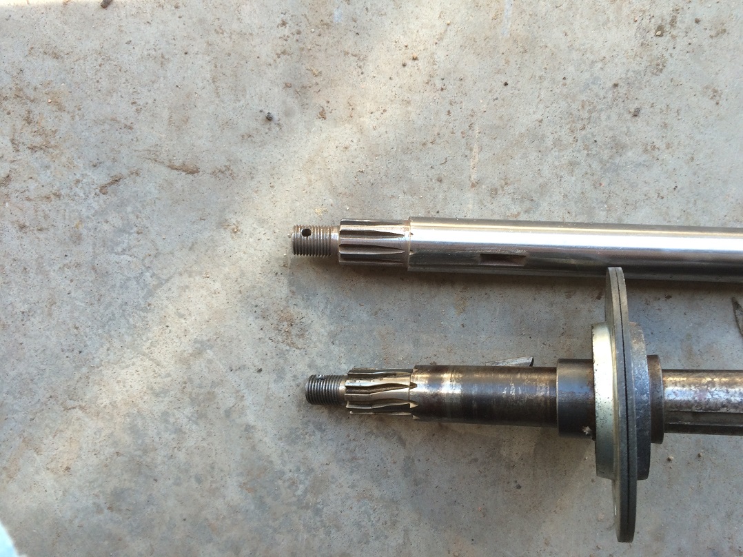

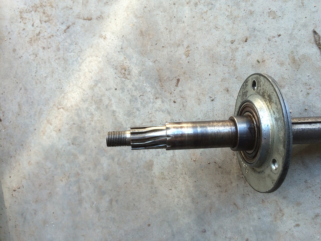

Here's the secondary shaft. Not sure, but I don't think the splines are supposed to look like that.

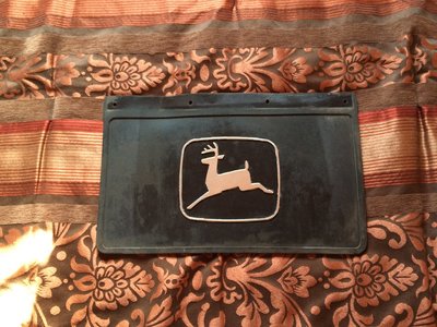

Here's the NOS one I acquired this week.

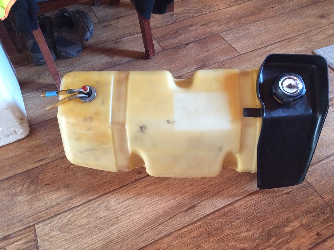

The fuel tank was a bit rough, but I've cleaned it, and flushed the inside. It also has a new check valve, and gas cap & gage that I got from New Breed Parts, and put in new pickup and return lines.

Yeah those splines don't look right hahaha
Re: 75' X8
Allan, I can't believe they could twist like that without something breaking! Hard to believe it had the torque to do that, but must have happened over a long period of time

Yeah I've never seen twisted ones like that
