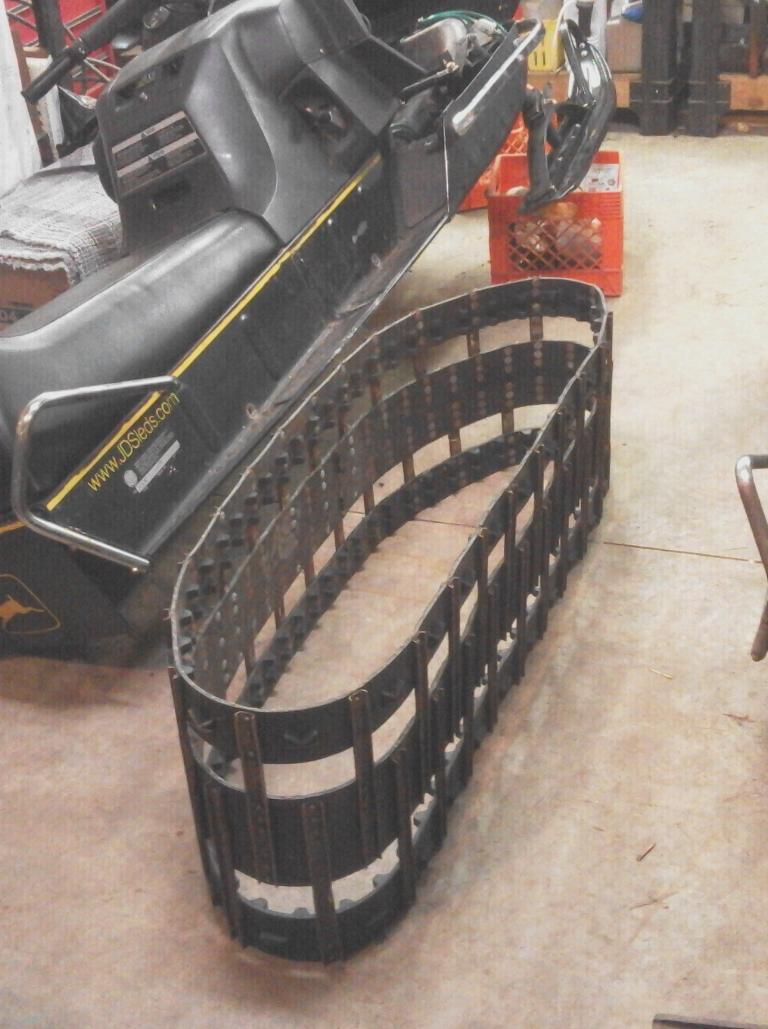

Track re-cleat is underway! 48 cleats, 432 rivets.

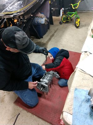

Since it has a scuffed up bore and piston, I did a complete tear down and ended up replacing everything from the crank, to the cases on up to the pistons and jugs. Richard is in training with learning to assembling Kawi motors. He helped to install the NOS cylinder studs into the NOS cases. He let me drop in the Jerome crank, but he put in the case bolts and helped snug them down...

Richard has been working away on the Liquifire rebuild. Motor should be all buttoned up by this weekend, and chassis work started going to. After 1,000 rough miles I figure she is due for drive axle bearings while the sled is down.
"I got this Dad..."

The X8 track rebuild is finally complete! 432 rivets cut off, 48 cleats replaced, 432 bolts installed and locktited. That was a bit of a slog!
Cleats were obtained from 3 different sources. Source number 2 should have left me with 15 extra, but the majority of the cleats sent were for OEM Deere, and I was left 5 short. The last 5 were obtained off ebay, and while they were the correct length ( 10 1/4 inches ) the rivet hole spacing was off. 3 holes had to be moved to the left, 6 to the right, all about an 1/8th of an inch. A chainsaw file walked right through them, and I don't think it would go that well if you tried that on a original Deere cleat.
