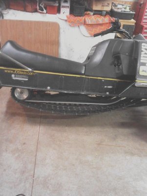

The X8 is getting some attention, and an upgrade.

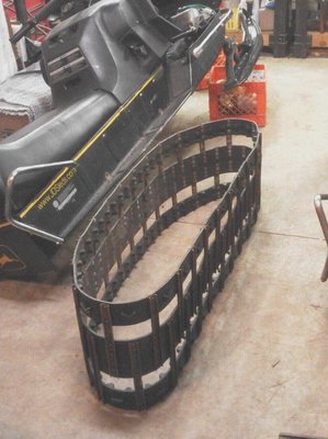

One month out, things are pretty much torn apart.
Re: Countdown to the RWTC
Track re-cleat is underway! 48 cleats, 432 rivets.

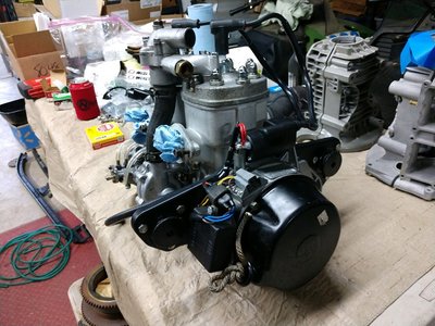

After being run a little low on oil last year, I figured it was time to freshen up the 80 Liquifire motor before the I-500/VC. I am planning to have it ready for the HoF this year just in case the Dator doesn't survive the I-500 again, because, well, things happen...

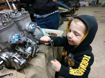

Since it has a scuffed up bore and piston, I did a complete tear down and ended up replacing everything from the crank, to the cases on up to the pistons and jugs. Richard is in training with learning to assembling Kawi motors. He helped to install the NOS cylinder studs into the NOS cases. He let me drop in the Jerome crank, but he put in the case bolts and helped snug them down...
If any of you guys wonder if nicasil is tough, this motor ran about 30-40 miles without out and still crossed the finish line at the I-500 last year. One bore and piston was OK, the other was rough. We re-oiled the motor at the HoF and then loaned out for the RWC for another 120+ miles. After about 1,000 race and Vintage Challenge miles, this little Kawi 440 owes me nothing. The jugs are going back out for re-plating, the crank is going back to Jerome for check out...and the pistons go on my 'trophie' wall

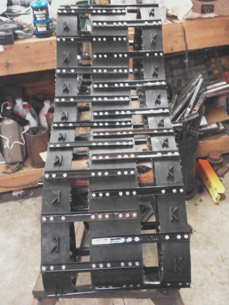

The X8 track rebuild is finally complete! 432 rivets cut off, 48 cleats replaced, 432 bolts installed and locktited. That was a bit of a slog!
Cleats were obtained from 3 different sources. Source number 2 should have left me with 15 extra, but the majority of the cleats sent were for OEM Deere, and I was left 5 short. The last 5 were obtained off ebay, and while they were the correct length ( 10 1/4 inches ) the rivet hole spacing was off. 3 holes had to be moved to the left, 6 to the right, all about an 1/8th of an inch. A chainsaw file walked right through them, and I don't think it would go that well if you tried that on a original Deere cleat.

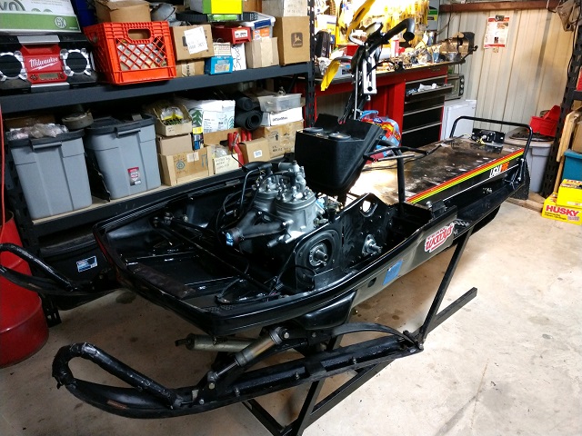

Like Lindner said, wrenches are flying all around...
The Liquifire motor is buttoned up with the small exception of carb flanges. Found that the old ones from 8 years ago were starting to dry rot and crack, so a new set were ordered from New Breed. While I started with the same motor from last year, not much of it is left. The cases and studs are NOS, a new Jerome Kretzman crankshaft, fresh jugs with nicasil, new Wiseco's and "CD" rings, new coil, reconditions set of heads, plus an NOS stator. So it's basically the same flywheel, recoil, flywheel cover, gear box cover, water, oil pump and manifolds from last year
Then it was onto the chassis. Glad to took it down for inspection. I haven't had the track out since I powder coated the chassis back in 2013, and it was due. Left side drive axle bearing was staring to go, and the jackshaft was toast again. Darn bolt on the top gear came loose, so the bearing ate the shaft on the chain case end. Good new was that the track and drive axle looked ready to go another thousand miles.
The suspension had two locked idlers wheels, and a small one was missing, but otherwise looked ok with no damage. All parts are on order and the last minute dash is on. The wiring hardness was scrapped and an NOS one installed to finally eliminate the gremlins I have been chasing for years.
At least Adam tells me the Dator starts and runs great, and is already loaded for the I-500. He seems to have that one mostly sorted out from last year. We shall see as I have a week before I head north...

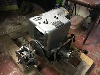

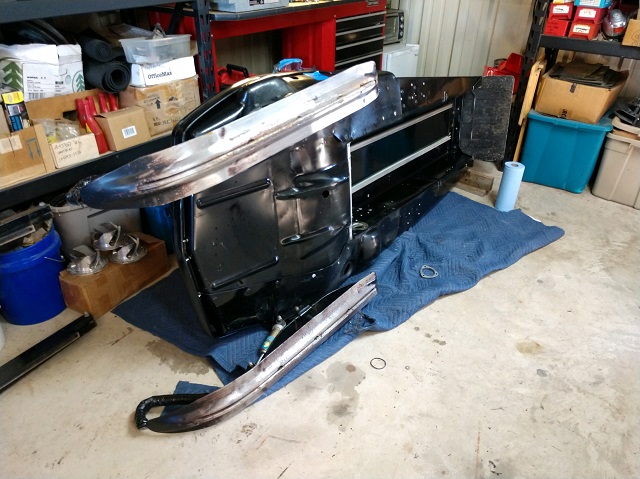

I figured I should jump in here to show everyone what I've been working on. Started as a sorry looking machine

The front suspension looked a little unique in one of the photos I saw on Facebook.......do tell.
