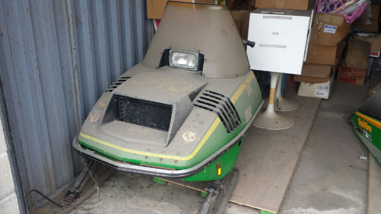

Liquidator 229 Rebuild
Cleaned up the sled and started the tear down and rebuild of the engine.

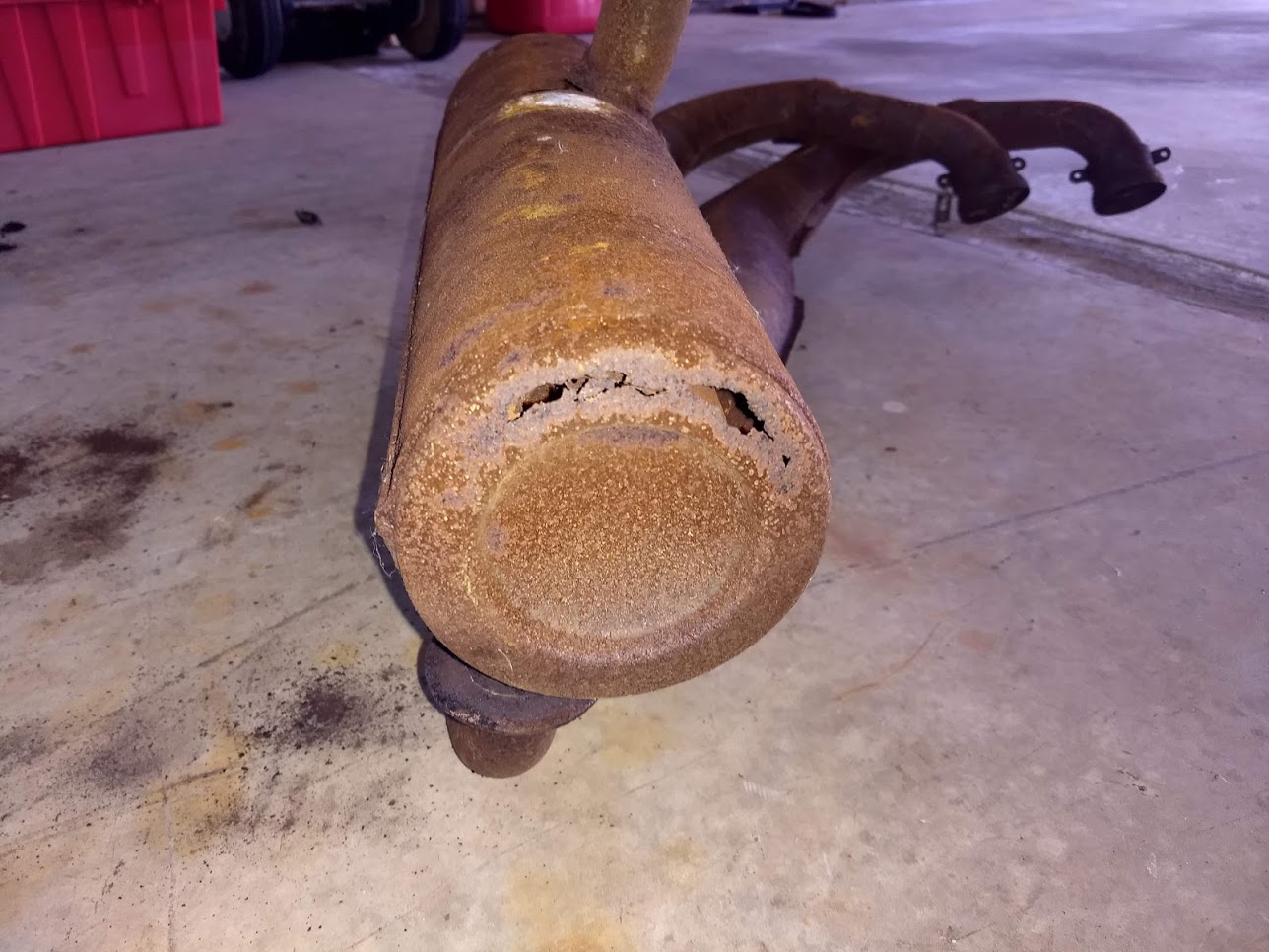

I got the exhaust apart, mouse condo in the muffler can. Pipes are solid, but the can is rough. Do they make replacement for the muffler or do I have to manufacture one?

I found a FB page that AAEN makes the pipes and the muffle as Don mentioned in an earlier post. When I check their site, I only see the pipes listed for sale, no muffler.

Re: Liquidator 229 Rebuild
They can make the can. I would just call them.

Got the can back from AAEN. Now on to fixing the pipes.
