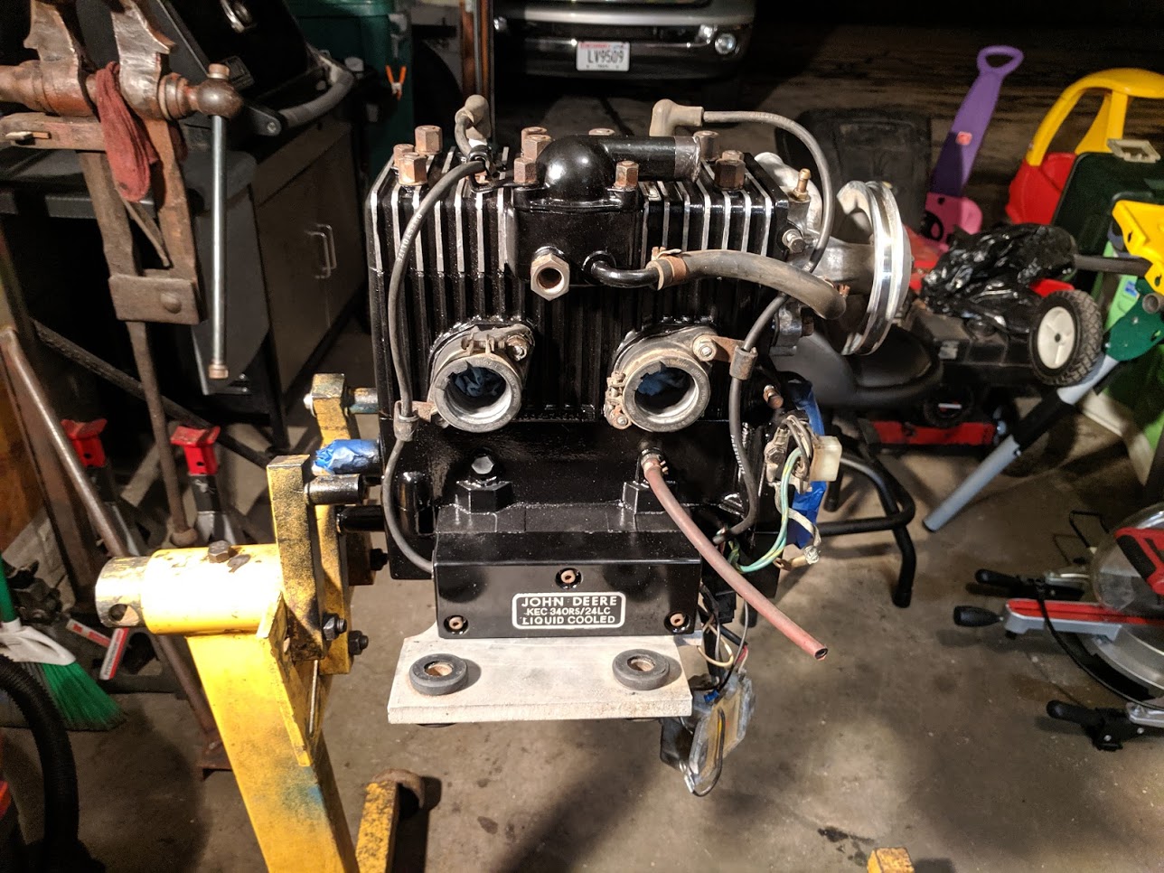

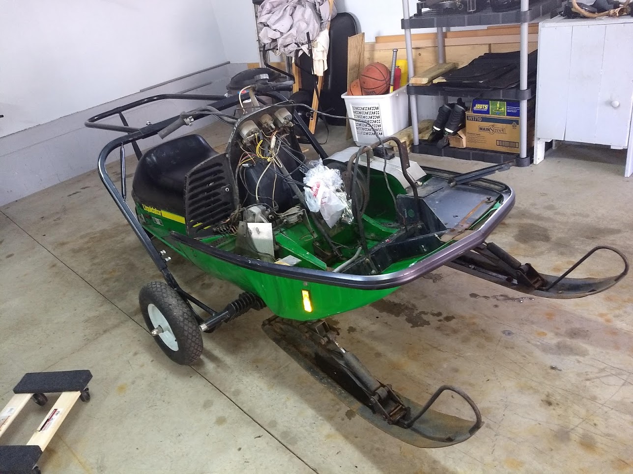

Liquidator 229 Rebuild
Cleaned up the sled and started the tear down and rebuild of the engine.

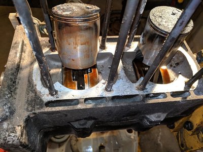

Re: Liquidator 229 Rebuild
Engine disassembly. Head was stuck onto the jugs, crank case did not want to separate. Unique tool designed.

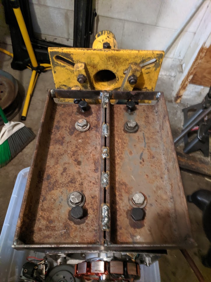

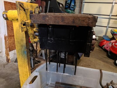

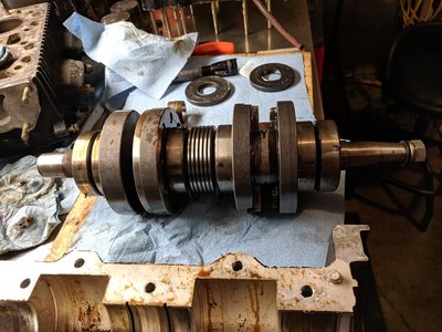

Crankcase separating tool. Crank looks good but does have some rust, so I will have it rebuilt. Exhaust looks rough.
Crank is shipped off to Jerome's.

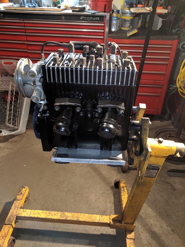

Engine reassembled.

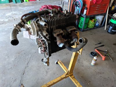

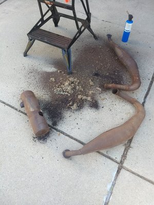

I got the exhaust apart, mouse condo in the muffler can. Pipes are solid, but the can is rough. Do they make replacement for the muffler or do I have to manufacture one?

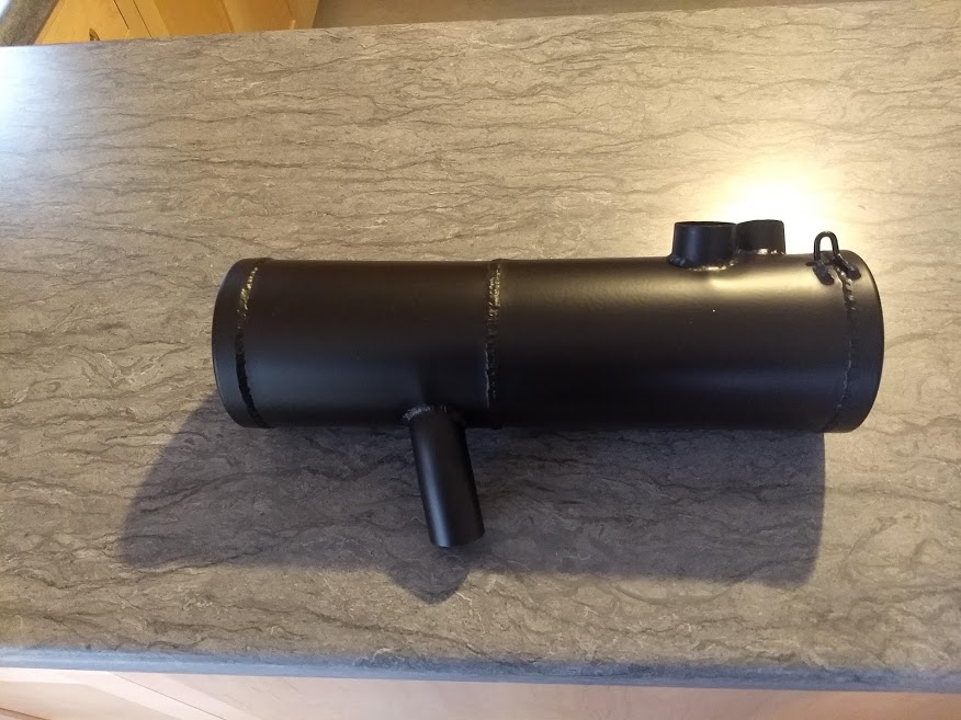

Got the can back from AAEN. Now on to fixing the pipes.
