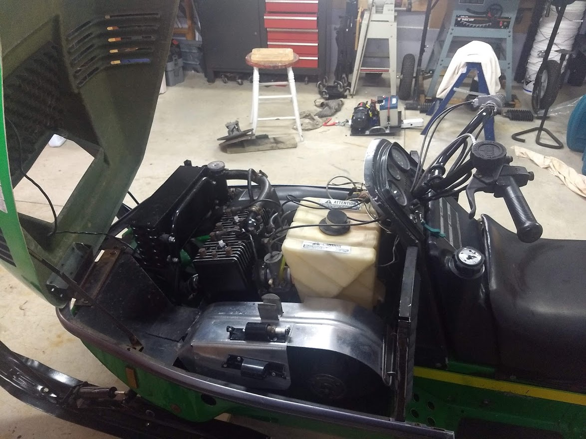

Started working on the sled again. Removed the chain case cover to check over the chain and gears. Everything looked good, except there wasn't any gear oil in the case. Next I pulled the skid and I will start going over that. Just a FYI it is 98% steel and weight 62 lbs.

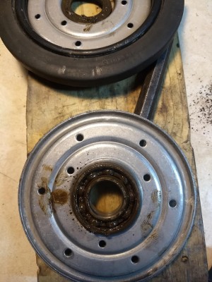

Made some more progress this week. Skid was cleaned up, painted, lubed and idler wheel bearing replaced.

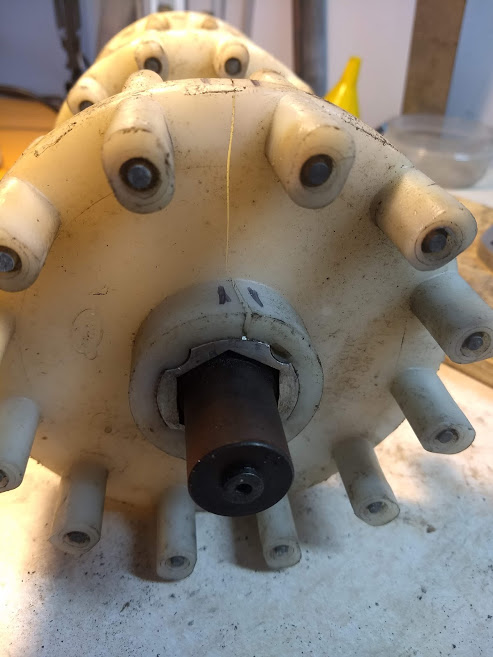

Found a few more problems. Chain case did not have any oil in it when I opened it. Chain has broken links, bottom gear is rough and the top gear is missing a tooth. Glad I hoard parts, found usable gears in one of my three chain cases.
The drives were also bad, cracked and brittle. Using a spare LF shaft and drivers as a replacement. Again, glad I store parts for a rainy day.

Do the Liquifires and Liquidators have the same pitch drivers and tracks?hounds84lhs wrote: ↑Mon Apr 27, 2020 9:58 pm
The drives were also bad, cracked and brittle. Using a spare LF shaft and drivers as a replacement.![]()

I was told the LF drivers could be substituted. I will let the Dator gurus give the pitch info.
