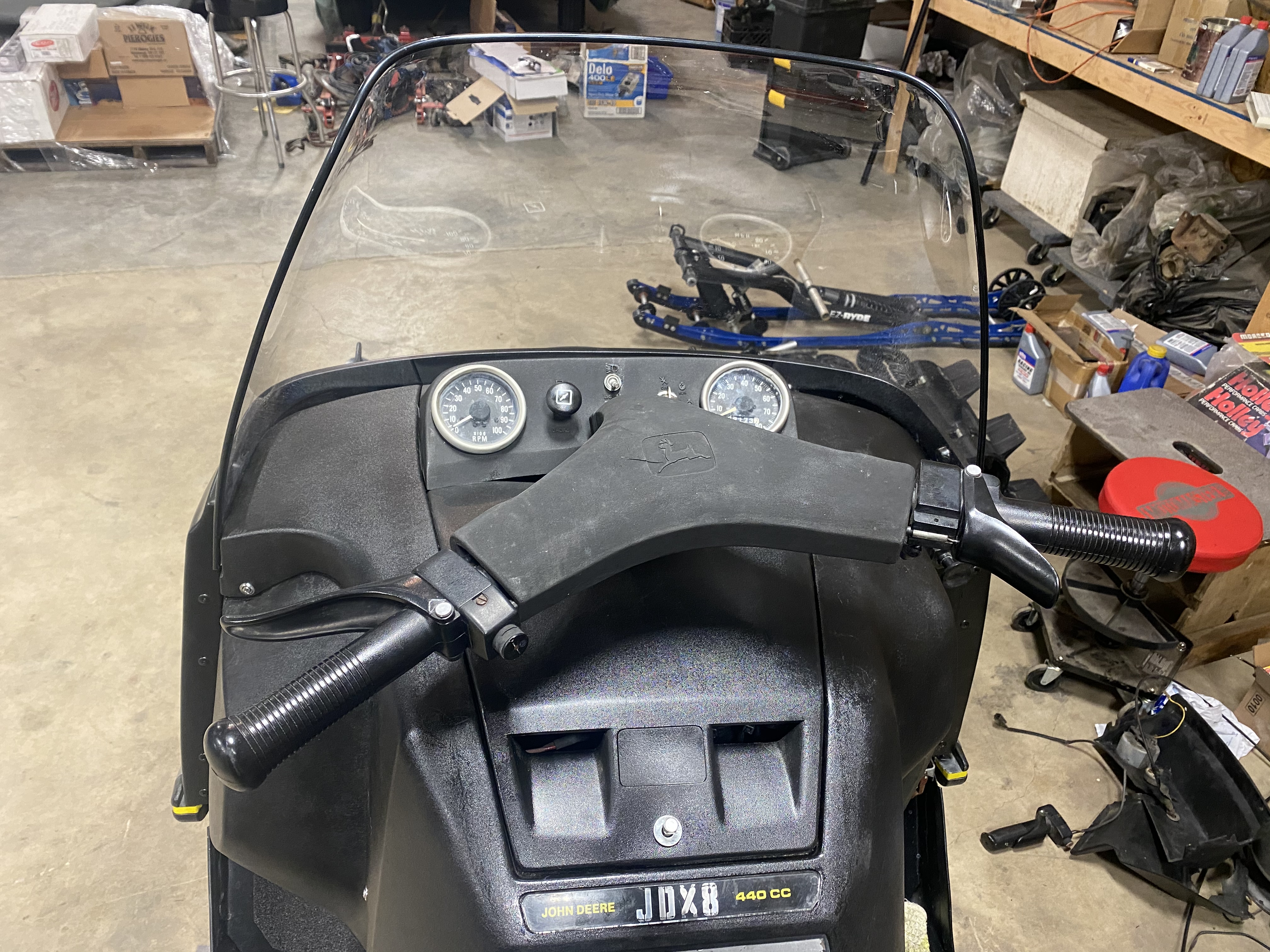

Wow thanks Brian. John Deere has some of the weirdest parts available lol. I bought brake band there also from info received here. Im very surprised. Anyway thanks again. Its been a interesting project.
