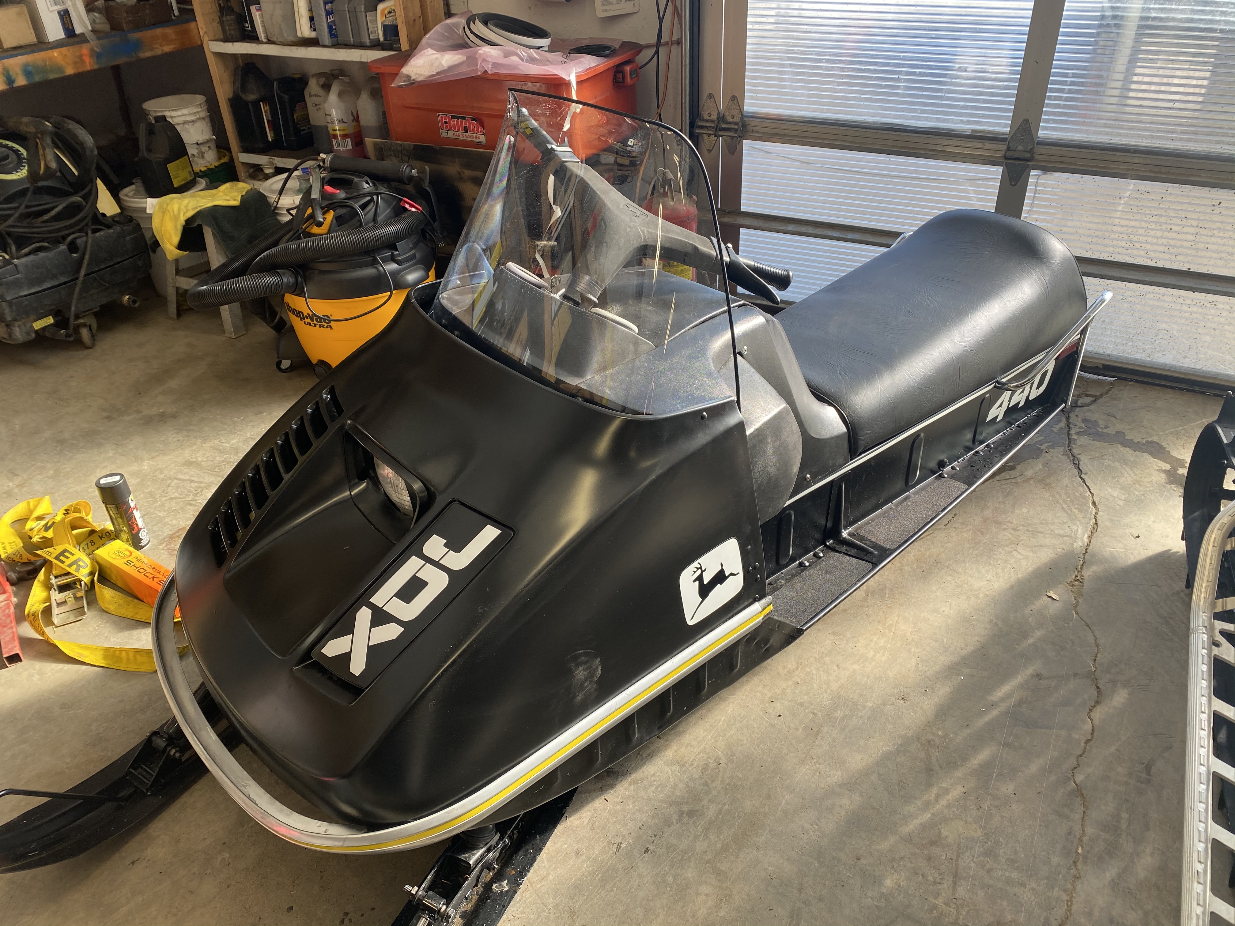

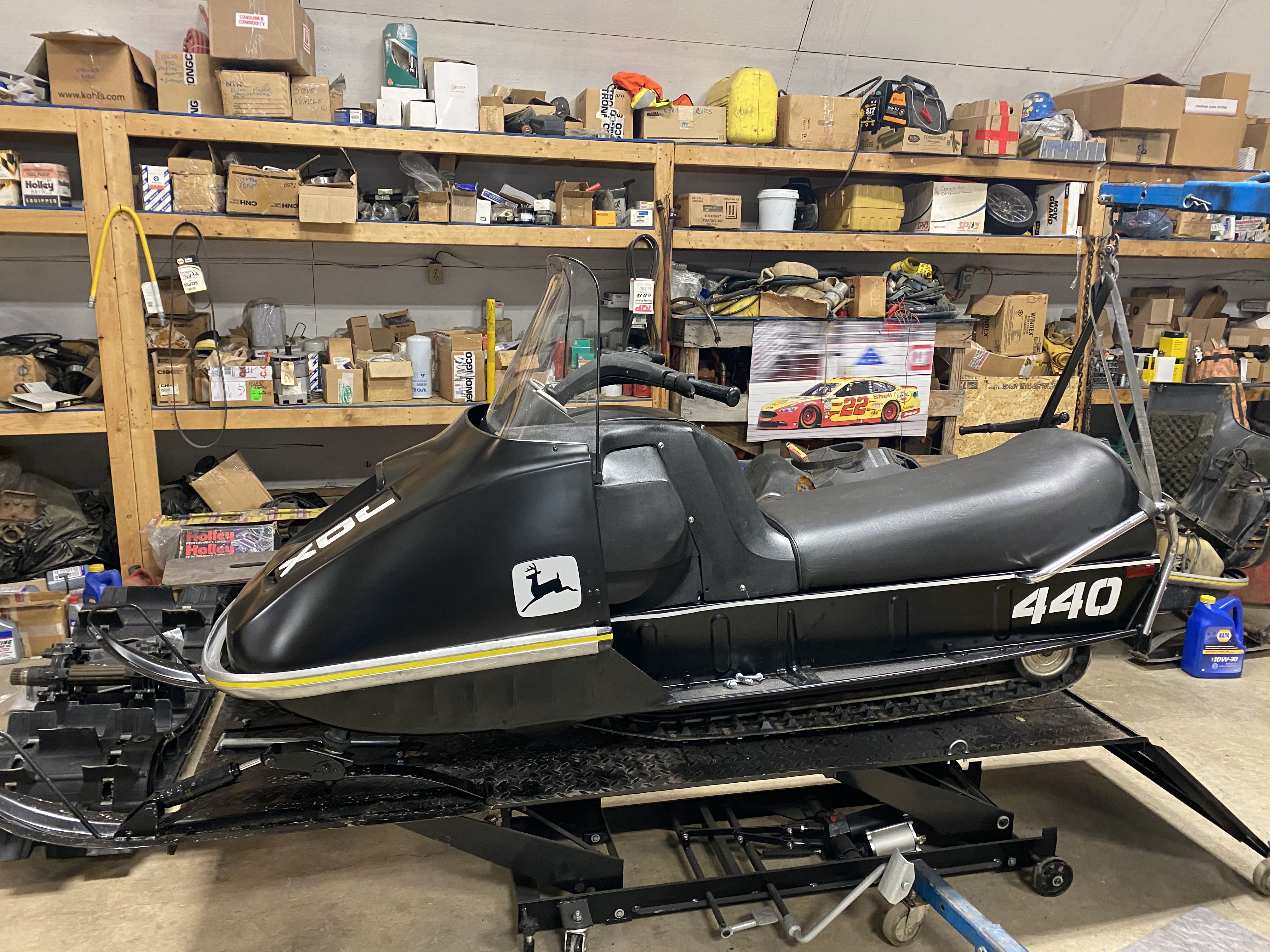

Thanks guys. Any tricks to get twisted one out? That cup it painful to get bolts out. Lol pretty much done other than that.

Wow thanks Brian. John Deere has some of the weirdest parts available lol. I bought brake band there also from info received here. Im very surprised. Anyway thanks again. Its been a interesting project.
