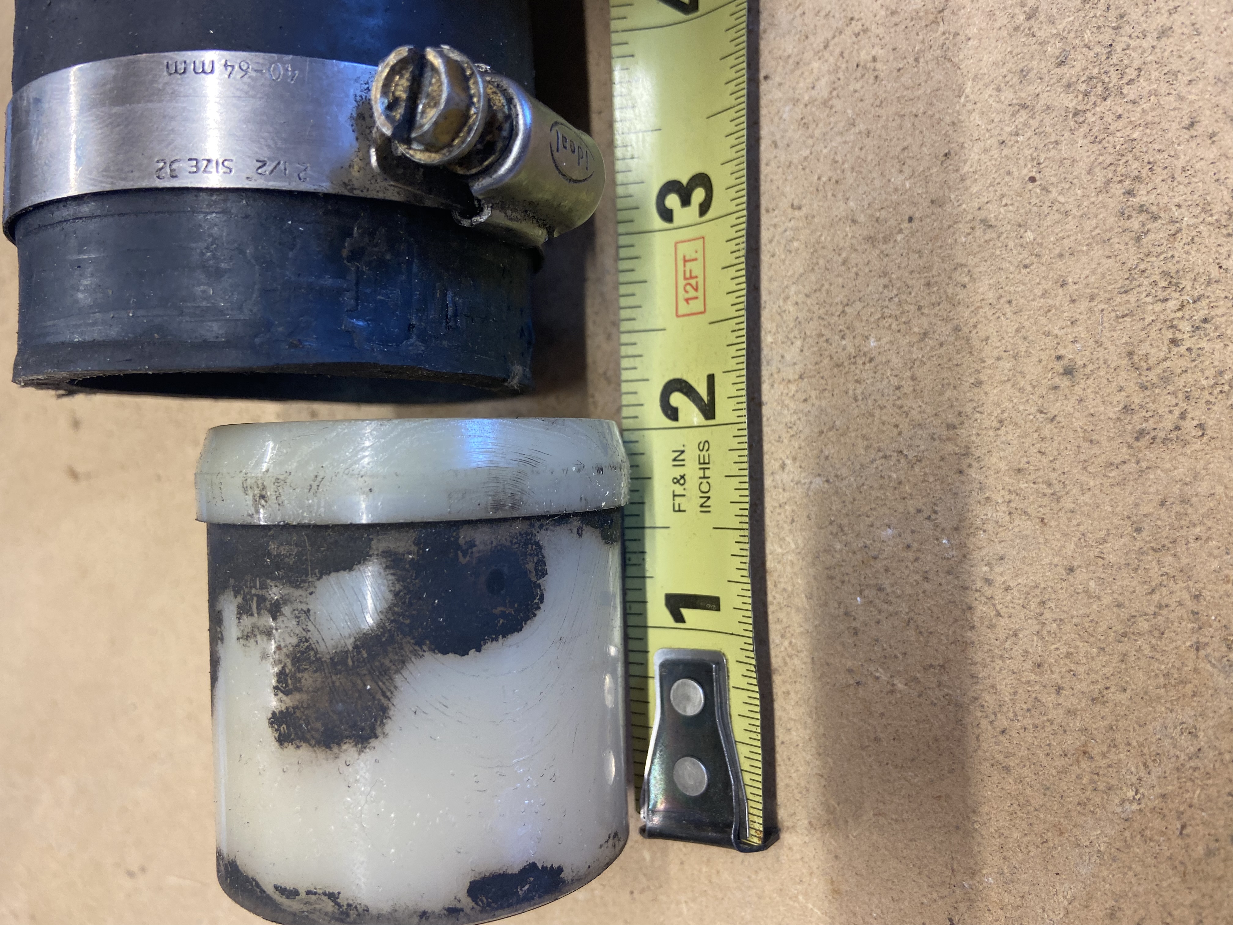

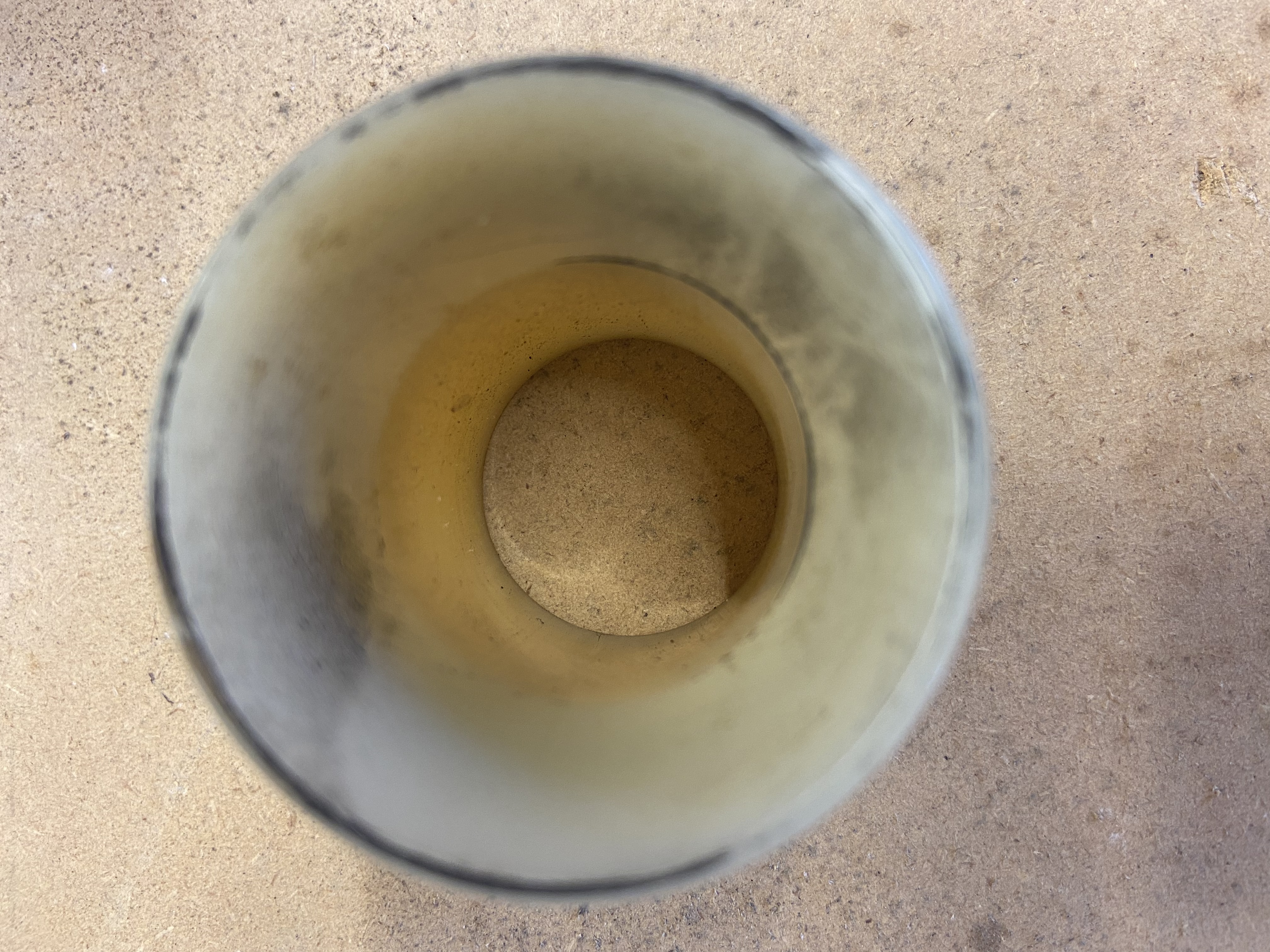

It looks to me like it’s basically a reducer tapered down from approx. 2” down to 1.25” I.D.
Here’s a few photos:
