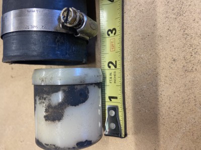

It looks to me like it’s basically a reducer tapered down from approx. 2” down to 1.25” I.D.
Here’s a few photos:

I could be way off-track here, but I presume the restrictor is designed to “meter” the air intake to sustain an ideal air to fuel combustion ratio. If removed, this could be compensated via the Carburetor Air Mixture setting, but I’m sure there is a very good reason it was included in the design by the original engineers.
As there was a different restrictor for the 440’s, it would make sense that the taper would not be as aggressive (perhaps down to 1.75”?) to supply a larger engine, so it may not be such a big deal if it is removed.
However, I suspect it would be much more noticeable for the 340’s if the air intake was 2” throughout. Again, this could be compensated via the Carburetor Air Mixture setting, but would not align with the original recommended setting of 1.5 turns out.
Thoughts?
