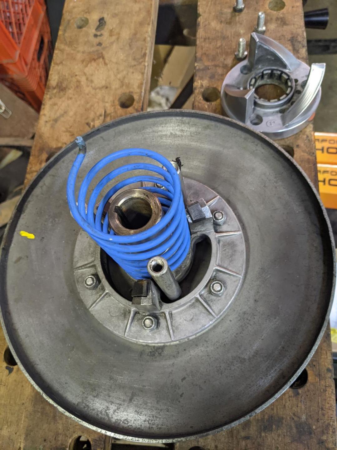

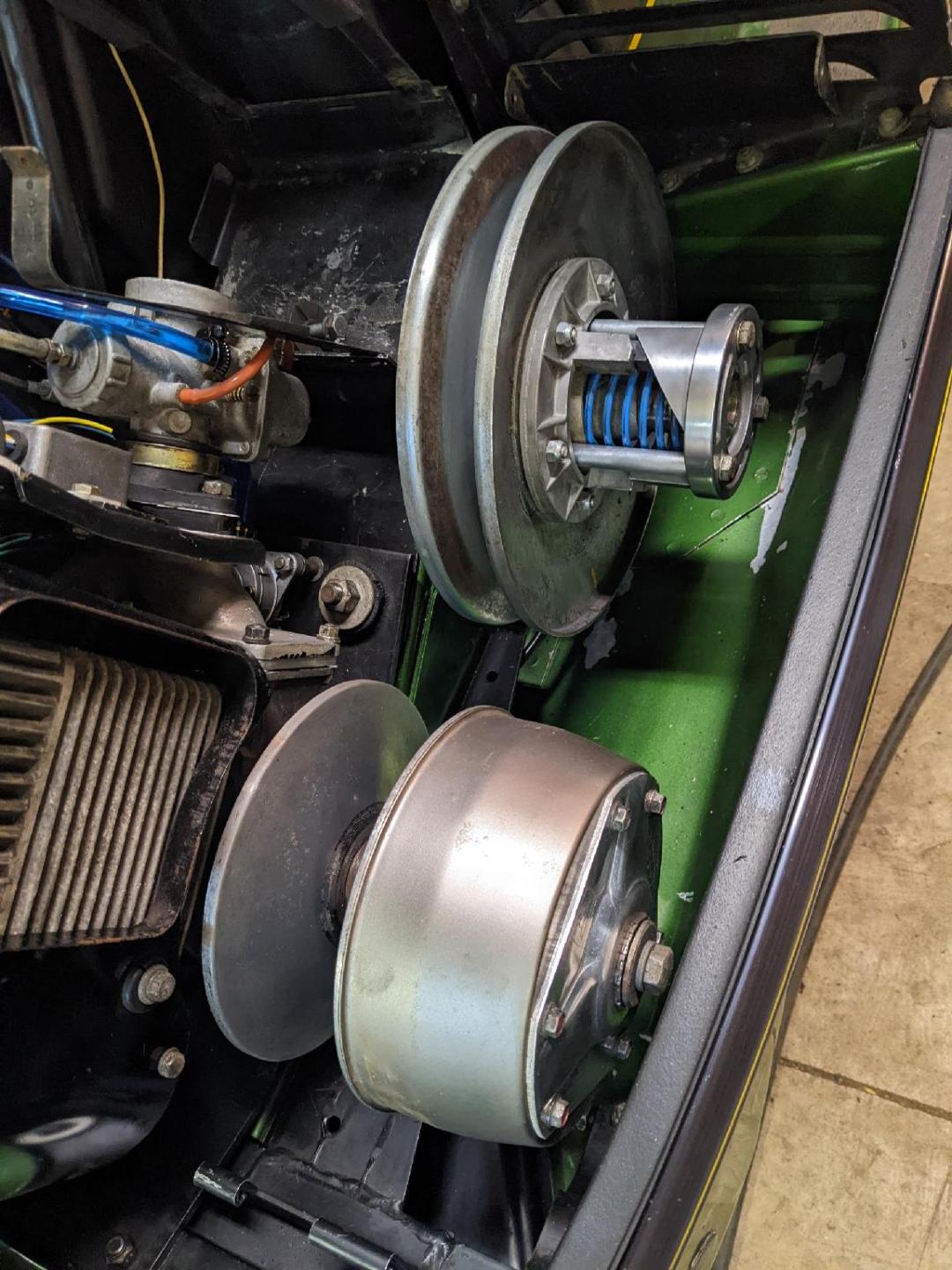

So, as this is a refresh not a restoration, the main thing here was to get the assembly clean. To really do a good job, the whole thing would have to be taken apart, the aluminum parts soda blasted, and the sheaves sanded clean, smooth, and ready for paint. Or if you were seriously gung-ho, re-plating.
Here I used Brake Kleen to get the crud off, then scrubbed the aluminum parts with a brass bristle brush, and the steel parts with a maroon Scotch Brite pad. I did sand the rust off the inner halves of the sheaves where the belt sits at rest. And I probably spent the most time on the helix. The ramps were showing some wear and the whole thing was pretty furry. I sanded the ramps smoother, and in the end was down to using a little Mother's Polish.
The spring was in good condition, so it was just cleaned, the Scotch Brite pad ran over it, and painted with what I had sitting around. Just a hint of blue was still showing.
These sheaves were marked where a ( I assume ) balancing weight was spot welded on. Don't recall ever seeing this on mid-mounts. An arrow was stenciled on showing these as if it was important to know, but I find no mention made of it in the service manual.

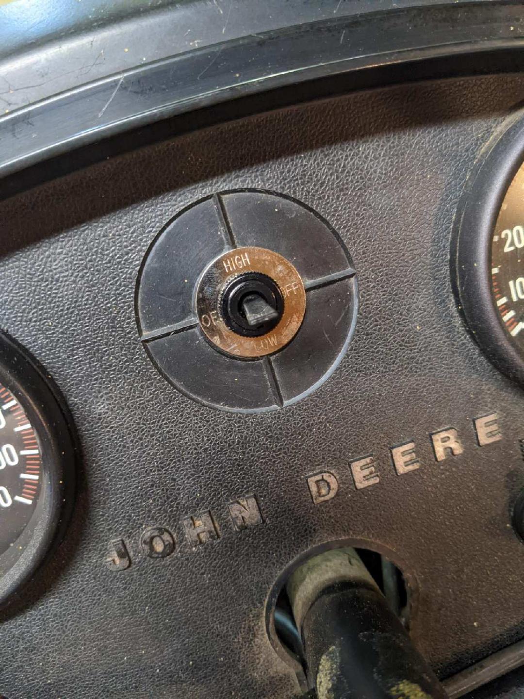

So on with the 76 Cyclone saga... I have said I needed to do something with the hole in the dash. After mulling my options, I have decided that what would serve my interests the best would be a switch. Specifically a switch for bar heaters.
I was reminded recently that after my wife Katy spent an afternoon riding Wade Bennett's 78 Liquifire a few years back, the thing she was most impressed by was the fact that the bars were warm. So I am thinking adding warmers might get me some appreciation.
At any rate, I had a set that I had purchased 15 years ago, so I might as well put them in.

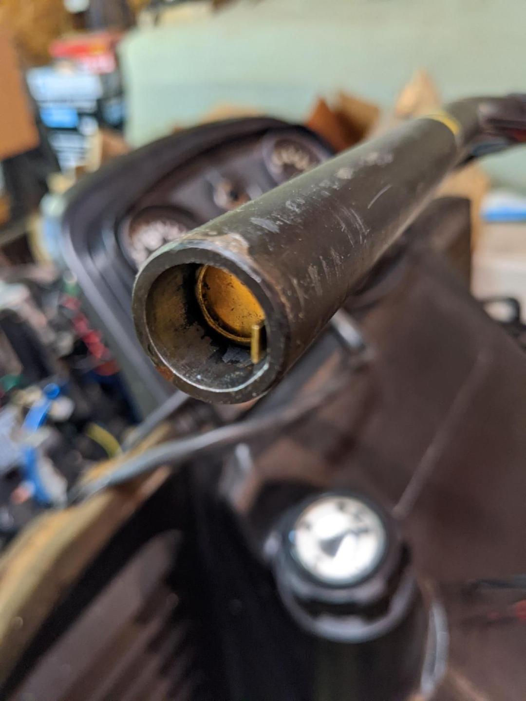

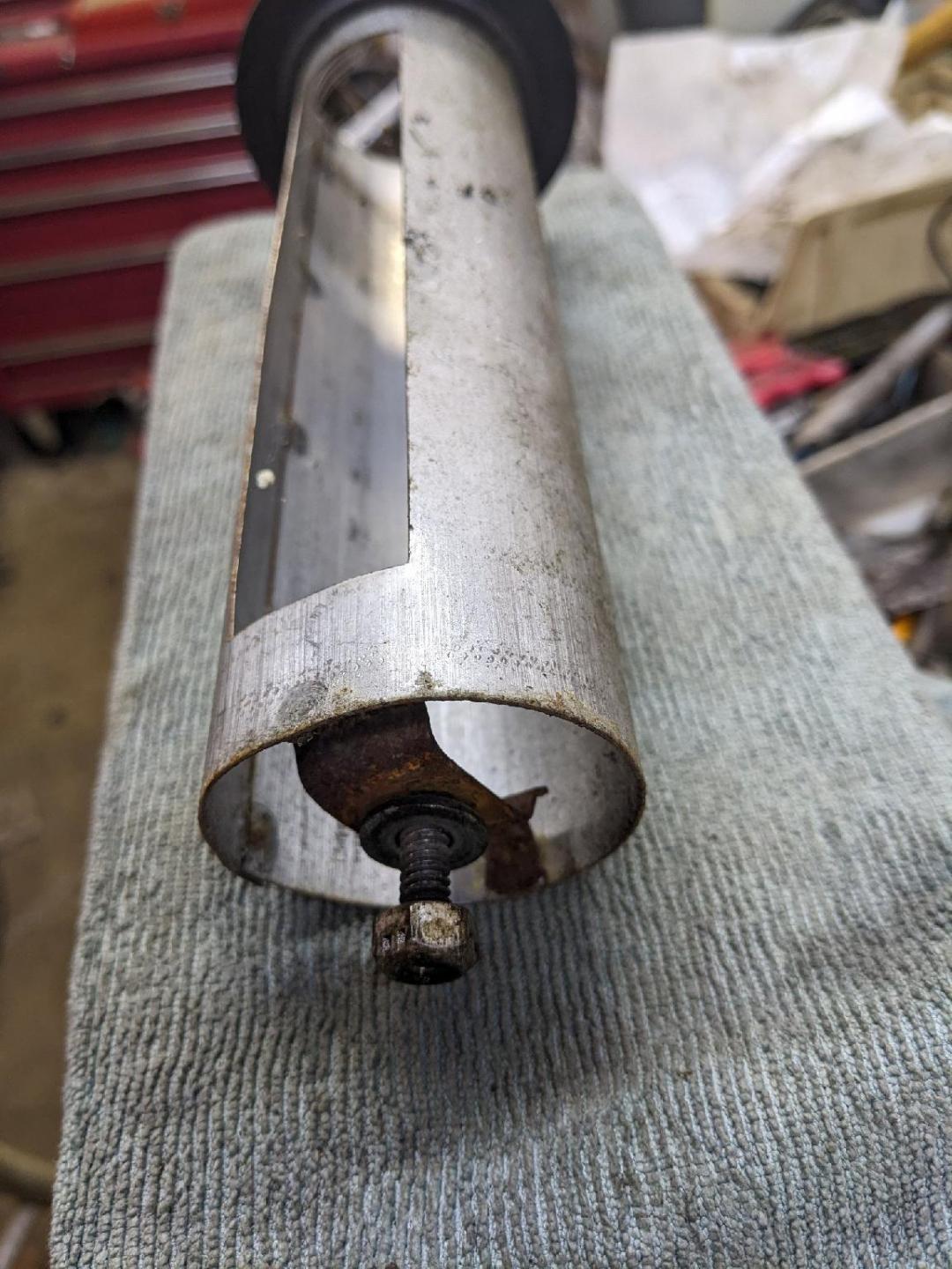

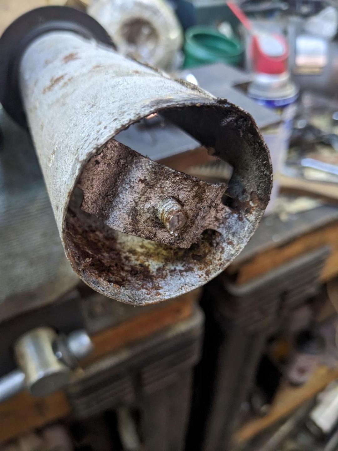

So I have been talking about this for a while, it was time to get it done.

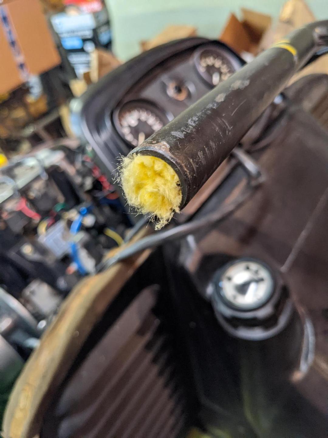

I slid the grips off the bars, and took stock of the situation. There was a substantial ridge inside the bar that needed to be removed before anything else could move forward. A round file cleaned that up, so I could now test the fit of the heating element.
This one is different from one I had installed many years ago. The early kit supplied lead foil to wrap around the element to make it fit tight inside the tube. This element has a tang spot welded on, which you can bend an arch in to make it fit tight.
I didn't need an arch in this case, I needed to file the tang down to allow the element into the tube. So I filed and sanded the inside of the tube, and filed the tang and polished the element until it would slide into the tube.
Next I drilled a hole in the tube between where the grip mounts and where the bar is welded to the steering shaft. I de-burred the hole so the grommet would fit well. Then I went fishing...a wire was ran thru the hole out to the end of the bar, the electrical wires attached, and pulled most of the way through.
A piece of the supplied fiberglass insulation is poked into the tube ahead of the element, a bit of soap was smeared on the element, then the assembly is pushed into the tube until it is a bit past flush. Insulation can then be added to the outside end. A grommet is slid over the three wires, a bit of soap added, and then the fun begins of getting the grommet into the hole. Once that was done the wires were taped to the bar up out of the way.
Then I got to move to the opposite side, and do it all over again. The switch has been installed in the dash, so all that is left is to get it all wired up.

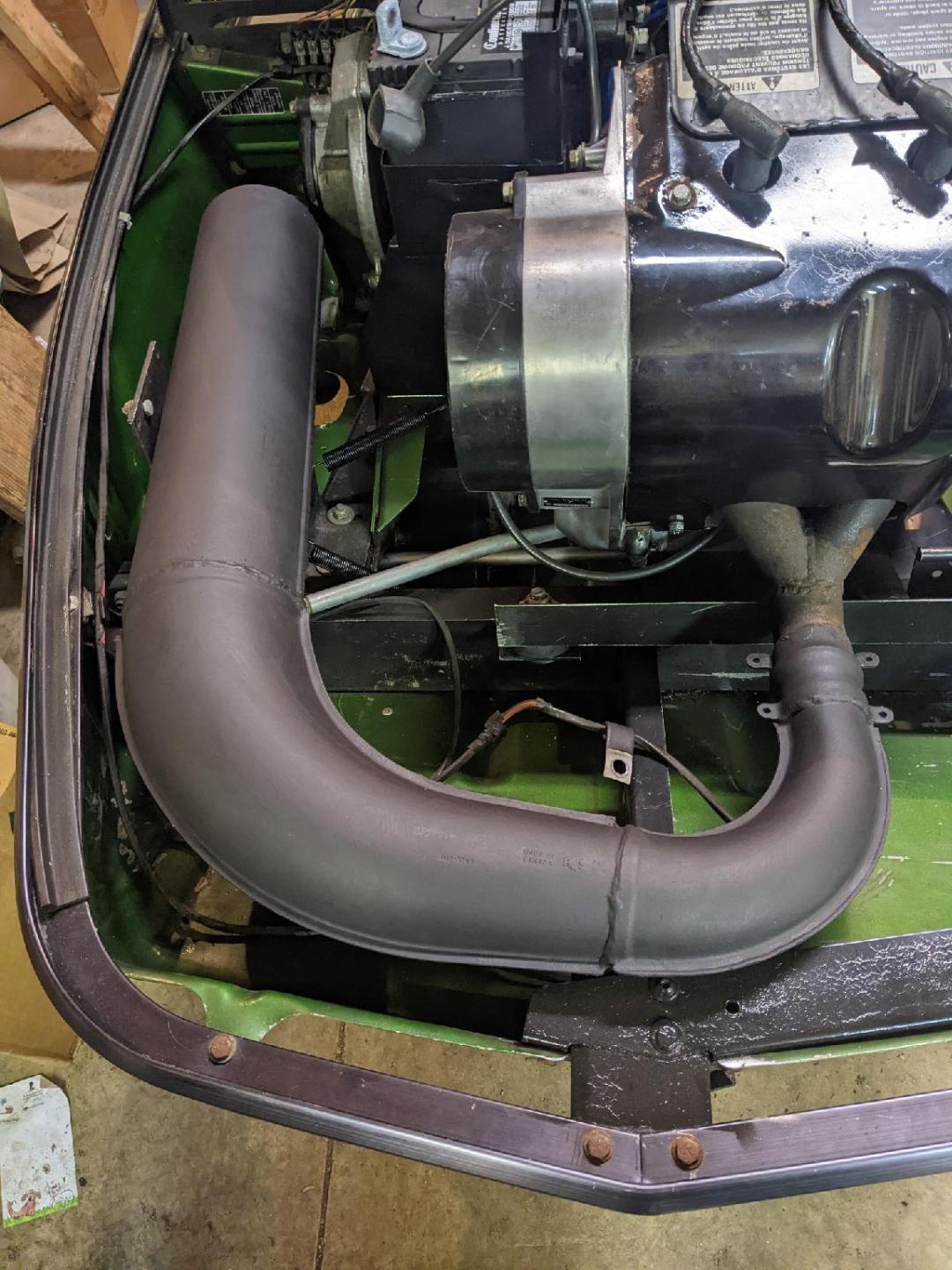

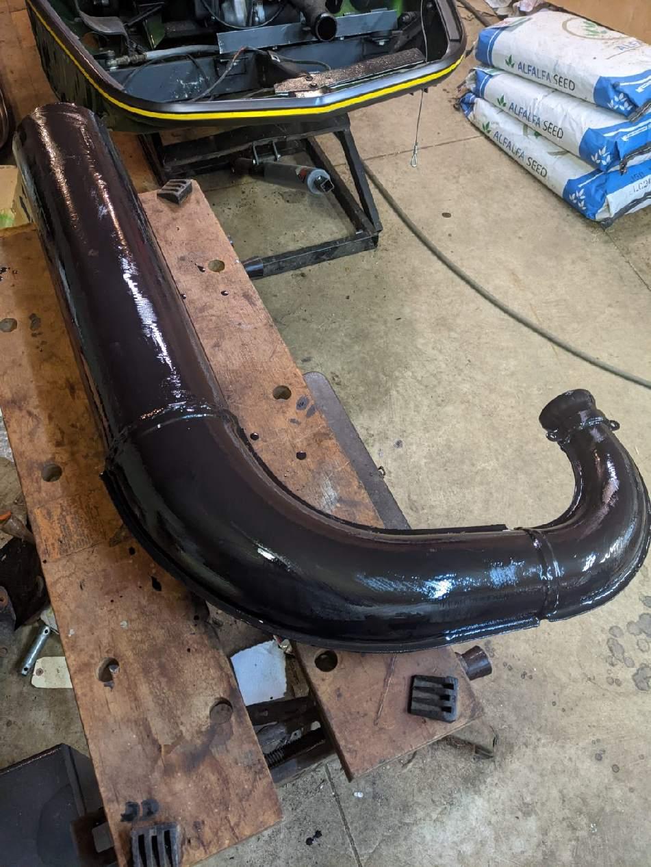

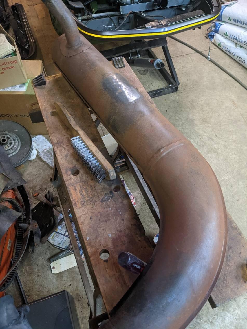

Time to freshen up the exhaust. I have been brush painting mufflers out of the same quart can of Hi-temp black for at least 15 years. If you ride the sled, painting the muffler will improve the appearance for a couple of years. Unlike the mid-mounts, the Cyclone exhaust is easily removed to remove and refinish.
I do not blast exhaust. Number one, you absolutely do not want grit to get inside the exhaust, because if you don't get it all back out, it can migrate back into the engine. Also the metal may be getting thin at this point, so I wire brush the loose stuff off, then sand the worst of the rust back a bit and paint it.

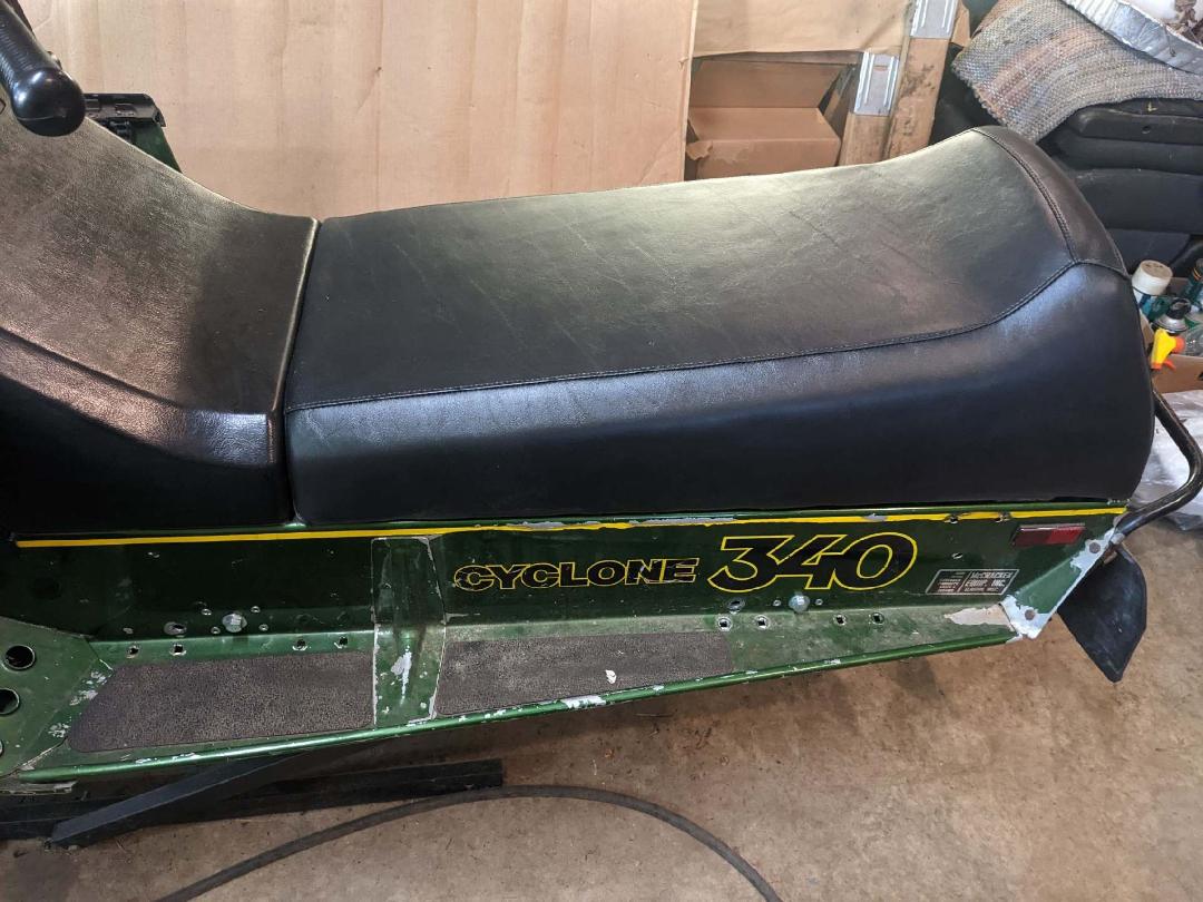

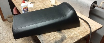

So the seat had been boxed up since July, waiting for John to give me the go-ahead to send it. He was busy at the time with cars it sounds like. Mid November I got the word, so the seat was sent via Speedy on Friday, Nov 18th.
I got a text from John on Monday, Nov 28 that it was ready to ship out. I know everyone will want to know what it cost. $250 which includes shipping back. This was a very nice seat, no repair was needed to the foam that I am aware of, just new vinyl and plywood. At the time I am writing this, I don't know what I paid to have it shipped to John's Upholstery, probably more than I think.

Here is the re-covered seat seat sitting on the sled!
And the exhaust has a couple of coats of paint on, and is looking pretty good.

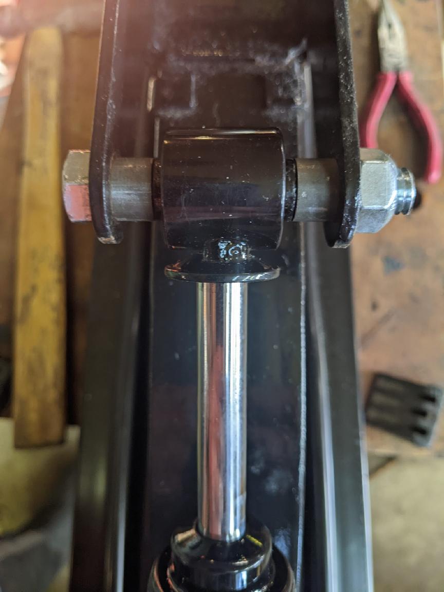

Finishing up the skis by installing the shocks. These are the SPI hydraulic shocks sold by New Breed and other suppliers.
I cut bushings out of tubing to center the upper mount.

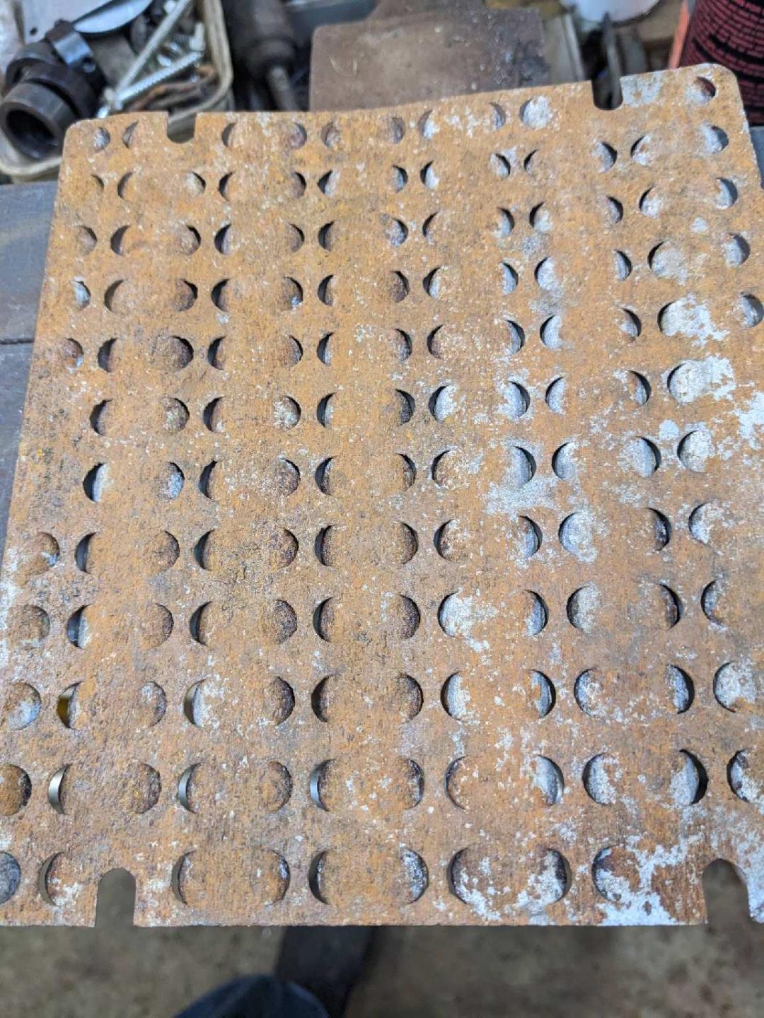

Re: Cyclones!!!

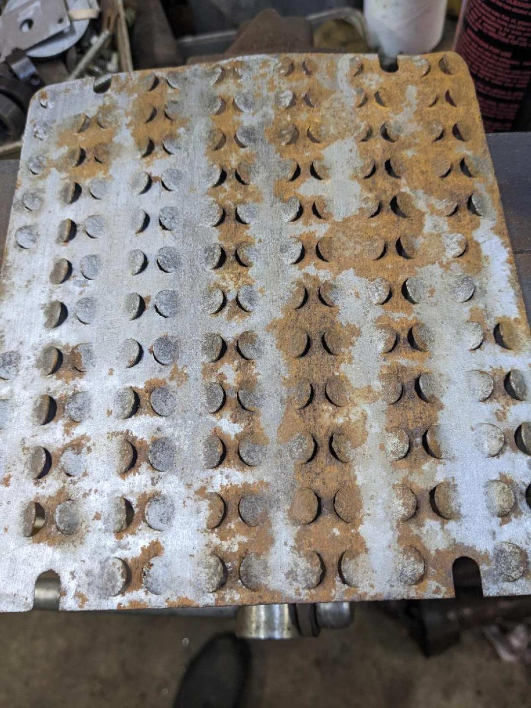

So I attempted to remove the tube on the air box, and I thought I had the nut turning, but despite my best efforts I twisted it off. However the airbox that came on the sled that is stuck together cooperated and I took the tube out of it.
The rodent barrier plate is a bit corroded ( mouse pee will do that ). I wire brushed it and got it looking better.
The box body has been washed out. The only thing left is to clean up the carb boot, it is kinda dirty.
