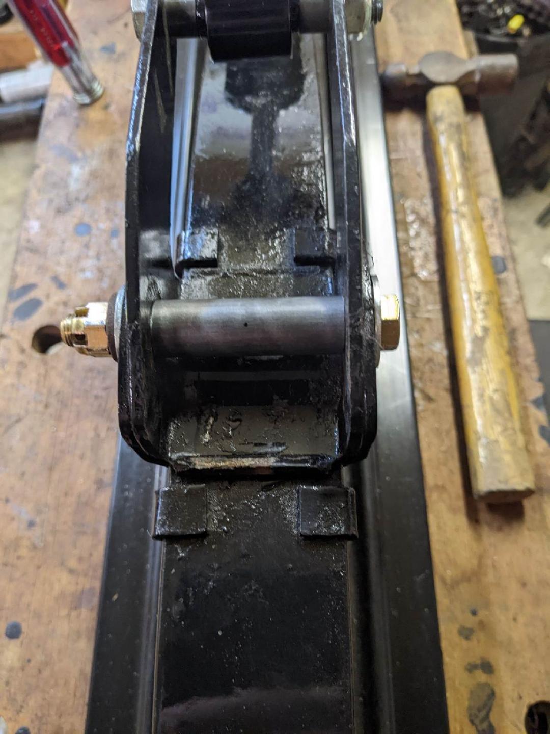

So as I was installing the ski shocks, I had the pivot bushings installed to make sure everything was where it should be. After the shock installation was complete, I just happened to check the bushings, and discovered they would spin freely on the bolt! I put a bit more torque on the bolt, but the original stock bushing not only spun, there was detectable side to side movement.
The bushings are supposed to turn in the spindles. If they are not pulled tight in the spring saddles, the bushing can turn on the bolt, or the bolt can turn in the saddle. If I had not checked this by accident, I would have installed the skis to the spindles and assumed everything was good.
The original bushings measured 1.992" by my caliper. I have been cutting my own bushings out of thick wall tubing for years, and I normally cut them at around 2". As far as I know, pulling the bushings tight in the saddles has never been a problem.
I cut two bushings. One measuring 2" and the other 2.028" On trial fit, I found the 2" bushing remained loose in the saddle. The 2.028" bushing could only be installed with a hammer, and that was never going to allow installation on the spindle. I shortened the bushing to 2.013", and found that was still too tight a fit. Back to the bench sander, ground it down to 2.008", and I finally found a good fit, and it snugged up with the bolt. Checking the other ski, I found the 2" bushing a good fit that pulled tight.
The mono-leaf spring set up on the Cyclone is different from anything else I have worked on. Essentially, the saddle is twice the thickness of the mid-mount saddle. The result of that is that the 3/8" fine thread bolt used to attach the ski to the spindle won't pull the saddle together very much. The bushing needs to fit tight as a result.
So hopefully I have this resolved, installing the skis could yet be a headache. I don't intend to install the skis until the sled is ready to come off the lift because I don't want to walk around them.
The bushing is installed with a AN6-32 aircraft grade bolt and castellated nut. It turns out that is a little longer than I needed, an AN6-30 bolt would probably been a better choice. By design, aircraft bolts have a short threaded section. The idea is to have the full diameter of the bolt in shear, and the threaded portion out of that zone, just holding the bolt in place. You do not typically use a bolt in tension in an aircraft. So, because the bolt is a bit long, I had to put a washer on each end, plus the original thick washer Deere used. AN bolts are pricey, as an example I included a pic of how they are shipped. I have been running these in my sleds for 15 years or so, 1000s of miles, many hard Vintage Challenge rides with no issues. AN bolts are designed to bend before they break.
