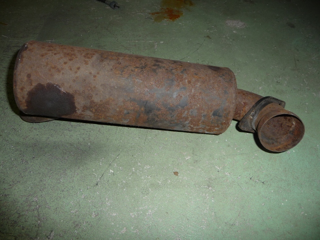

I have an original used that is in great shape, and I was lucky enough to find a NOS muffler for my 1972 400. If you want the used one, I will give it to you, you will just have to pay shipping. If your interested! Here r some picks:
- P1040652 (640x480).jpg (225.06 KiB) Viewed 2501 times
- P1040653 (640x480).jpg (235.25 KiB) Viewed 2501 times
- P1040654 (640x480).jpg (210.78 KiB) Viewed 2501 times
1972 400
1972 400
Re: 72 Muffler
Ebay item #230557976785 looks similar.

Re: 72 Muffler
That is for '74 and up 400, 500, 600 and JDX4 Specials.AirborneX4Special wrote:Ebay item #230557976785 looks similar.

- jeffreyrempel
- Posts: 292
Re: 72 Muffler
This muffler is Only for 1972 400 and 1972 500, Trust me. Thank You!

- jeffreyrempel
- Posts: 292
Re: 72 Muffler
or maybe your talking about the ebay Item. But the pictures of my muffler is for 1972.

- GreenFever
- Posts: 99
- Joined: Fri Dec 12, 2008 1:00 am
- Location: Thumb of Michigan
Re: 72 Muffler
Yeah I was talking about the Ebay Item. I knew your muffler was a '72. Looks nice. Can't believe it still has some paint on it after 38 years.
