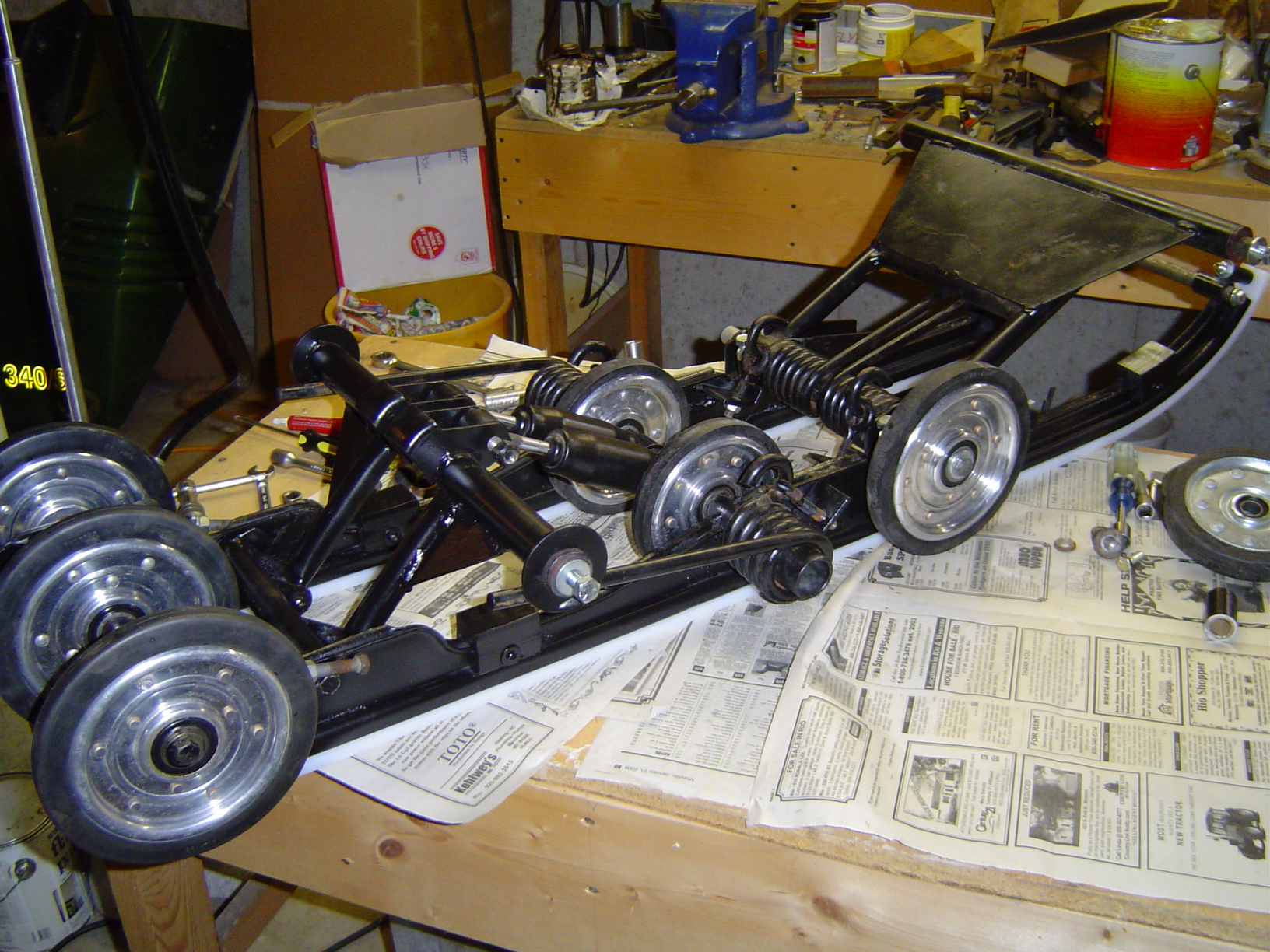

The skis on the sleigh look likely to be correct for the 340/S.
My suspension; the nose wheels aren't installed in this photo, looks like one is laying there on the bench.

Suspension on the right is a Liquidator heavy suspension.
Re: Barn find
The one on the right is not a 340/S suspension.340sracer wrote:Thought I had a spare suspension for the 340S, the rusty one on the left is the one that came back with the sled. The one on the right I found in a shed, but the front arm is shorter & it has a single shock so am not sure it will fit the 340S. The one on the right can have 4 wheels attached on each side of the slides, which I thought we ran in the cross-country races because of marginal snow in places.

The correct driver is on the left. One center wheel.340sracer wrote:The track drive with the double center wheels came with the sled, will it work on the 2 /3rd's split track? In the parts book it shows only one center wheel .

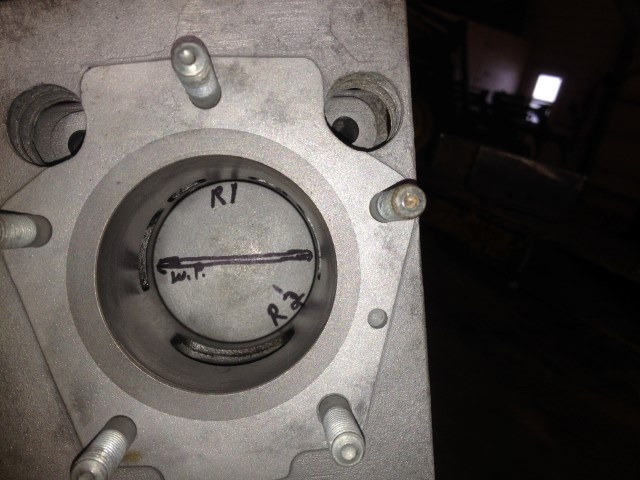

There is an oops, in our haste to get the engine apart to get the crank done the pistons were not marked properly, and by just looking at them it is hard to tell which way they go in. I don't have a 340/s service manual ,but in the Cyclone book it says they must be marked when you take them out to make sure you get them back in the same way. Any suggestions to get this thing back together properly.

The 340/S pistons are not marked in any way I know of, my recollection is that there is only one way they can be installed ( orientated ) that will keep both ring gaps out of a port.
The 340/S Service Textbook just says that mechanically the RS/2 is similar to the production engines. I do not have my SM2100 shop manual in front of me at the moment.
Perhaps there is a better answer, but I'm thinking that if you locate the ring pins in the grooves of the pistons, mark the location on top of the piston with a felt tip pen, then compare that to the port locations, it may become obvious.
I've done this a couple of times, and I don't remember it being a problem. Let us know what you find.
In this photo, it appears that the top ring is facing the intake side.

Maybe this picture will help. The ring end gap lines up with the tear drops in the intake ports.

As you can see in the picture the end gaps line up inbetween the ports. When I gave the piston a half turn both end gaps lined up with the ports. So it's obvious which way the piston goes in.Then I noticed a faint mark I had put on the piston, but had almost disappeared when I cleaned it. Next time I will mark it better.

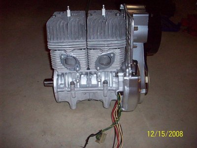

The basic motor is together, now I need suggestions where to find the plastic brake line & throttle cables for the twist grip.
