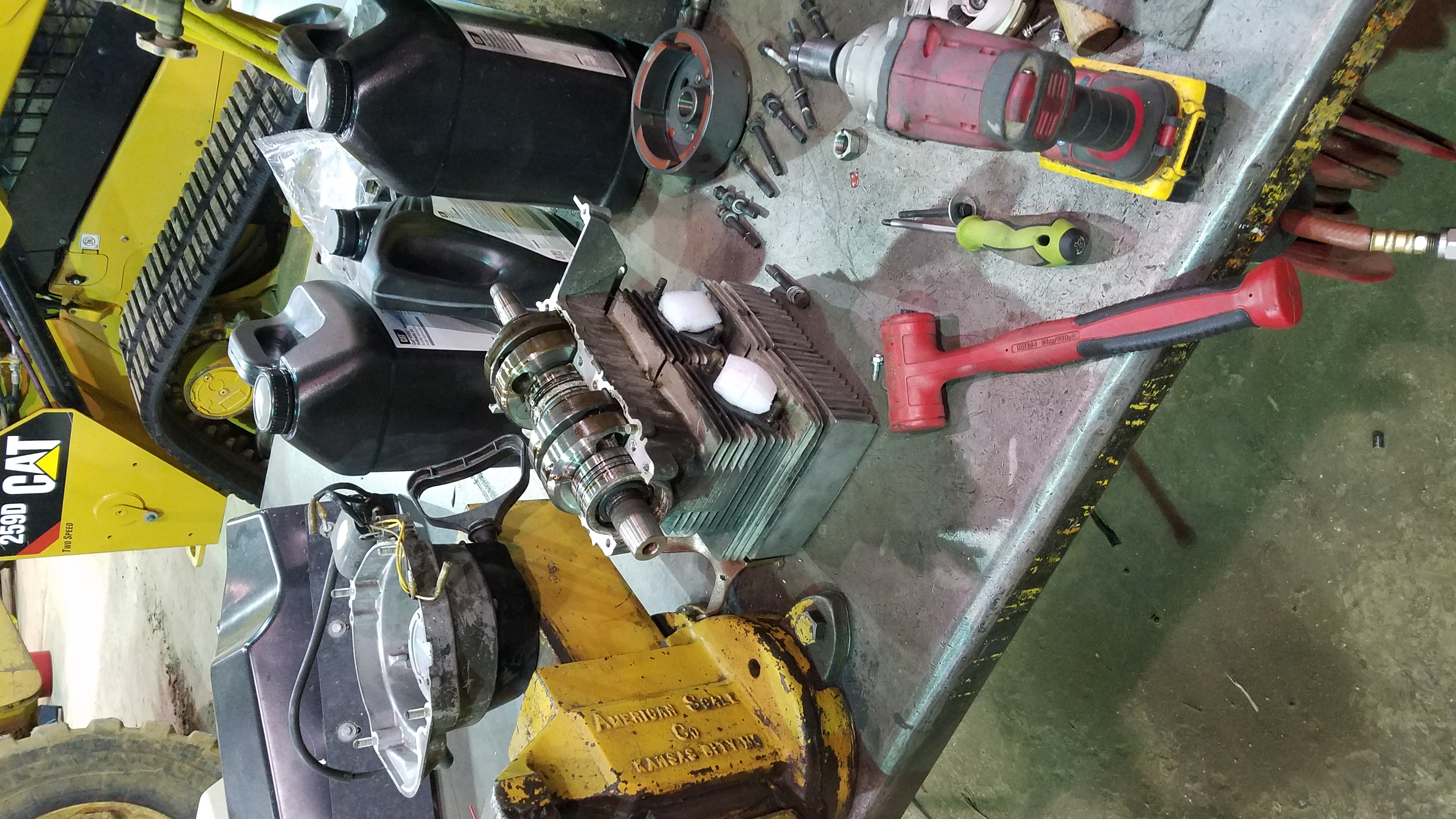

I need to split the case on this engine, but am unsure what is used to reseal the halves after new crank seals are installed. Any help is greatly appreciated!Image

Yamabond 4

Yamabond huh? Im not a big Yamafan, but if this is the most recommended method....its hard to argue against results!

I sell and use the Threebond version, no issues on my engines.
https://www.newbreedparts.com/newbreed/ ... asket.html
Re: TB340A Kawasaki out of 80 Spit; splitting the case
I have used both successfully, so it's buyer's choice.

But there's no gaskets, just this liquid gasket stuff right?

Correct.....no gaskets just sealant on the machined surfaces of the case halfs.

nick80lf wrote:Correct.....no gaskets just sealant on the machined surfaces of the case halfs.
Sent from my SM-G960U1 using Tapatalk
Awesome, thanks!

nick80lf wrote: Sun Feb 03, 2019 5:06 pm Correct.....no gaskets just sealant on the machined surfaces of the case halfs.
So no sealant on the seals themselves, just on the crankcase halves?

I don't coat the seals with sealant, but I do make sure where the seals sit in the case halves so very clean. I usually use a red scotchbright pad to shine things up and I make sure the grooves for the seal rib is clean and smooth.

nick80lf wrote: Fri Dec 13, 2019 12:55 am I don't coat the seals with sealant, but I do make sure where the seals sit in the case halves so very clean. I usually use a red scotchbright pad to shine things up and I make sure the grooves for the seal rib is clean and smooth.
Thanks Nick!
