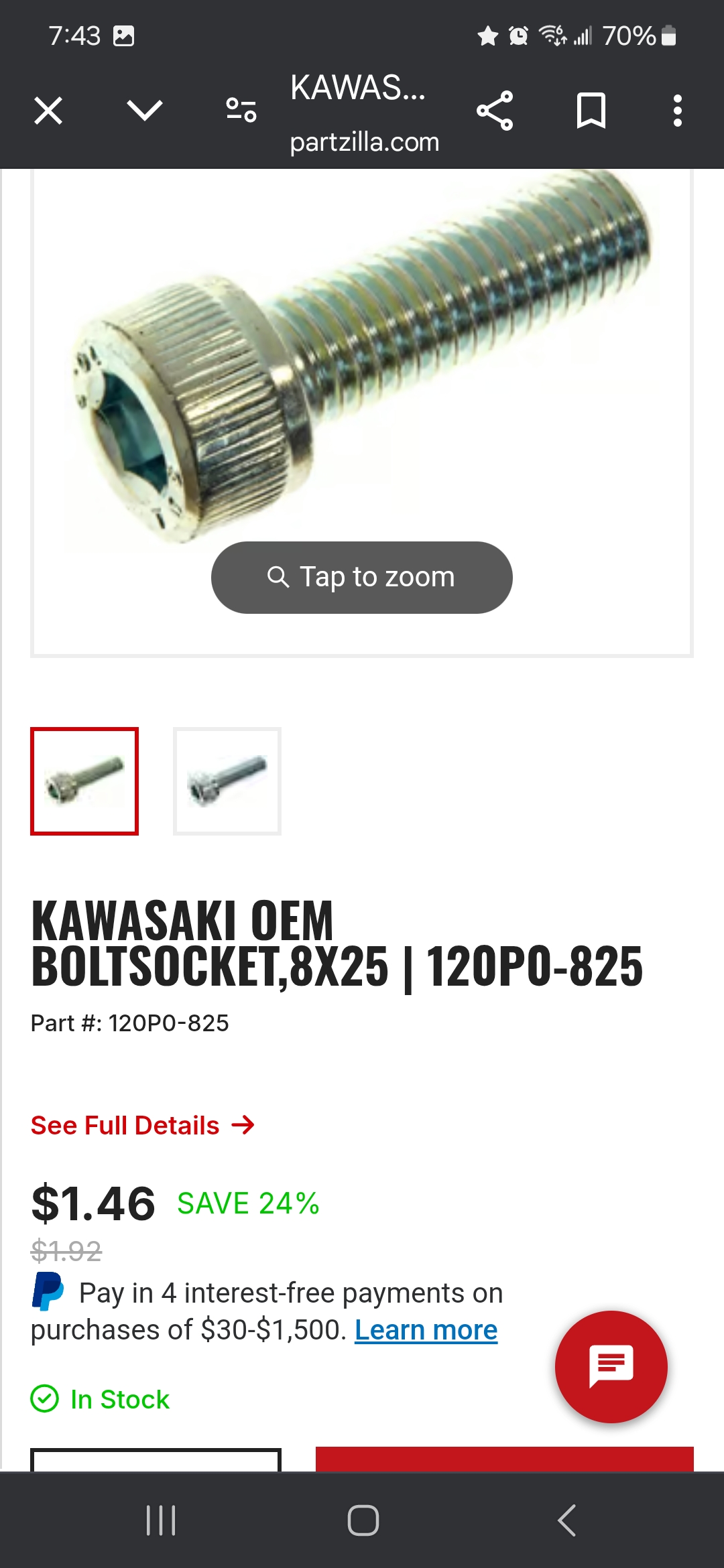

It seems I am missing some bolts. The other engine is also missing them so I can’t rob them from that engine. Does anybody know what size bolts go here in the bigger holes of the gear case cover and if they need washers and lock nuts? If so please let me know. Thanks
Re: 1981 Liquifire restoration
I looked at the parts book and it shows a bolt, lock washer and a flat washer. The book did not give a bolt size. They should be metric. Also make sure you have the spacer washer that goes over the hole in the case at the 2 o'clock position.

The four bolts around the crank bearing attach the crank side of the motor to the bulkhead. They are socket held cap screws. I'll have to dig and see if I can find some to measure the lenght. When i seal up the oil pump case i usually install those bolts to hold the cover tight until the sealant cures.
Seems like these socket head cap screws are M8x25. The Deere to kawasaki cross reference shows Deere M68115 is Kawasaki 120PO-825.

Thanks for the help on the bolts everyone. I believe I have them in the bin of bolts I received when I got the mostly disassembled sled. I was not sure which ones exactly they were however. I had kind of forgotten about the parts breakdown manual. My dad had pulled up some diagrams for me online before but I hadn’t thought to do that again. I might just end up printing the whole thing for future use.
