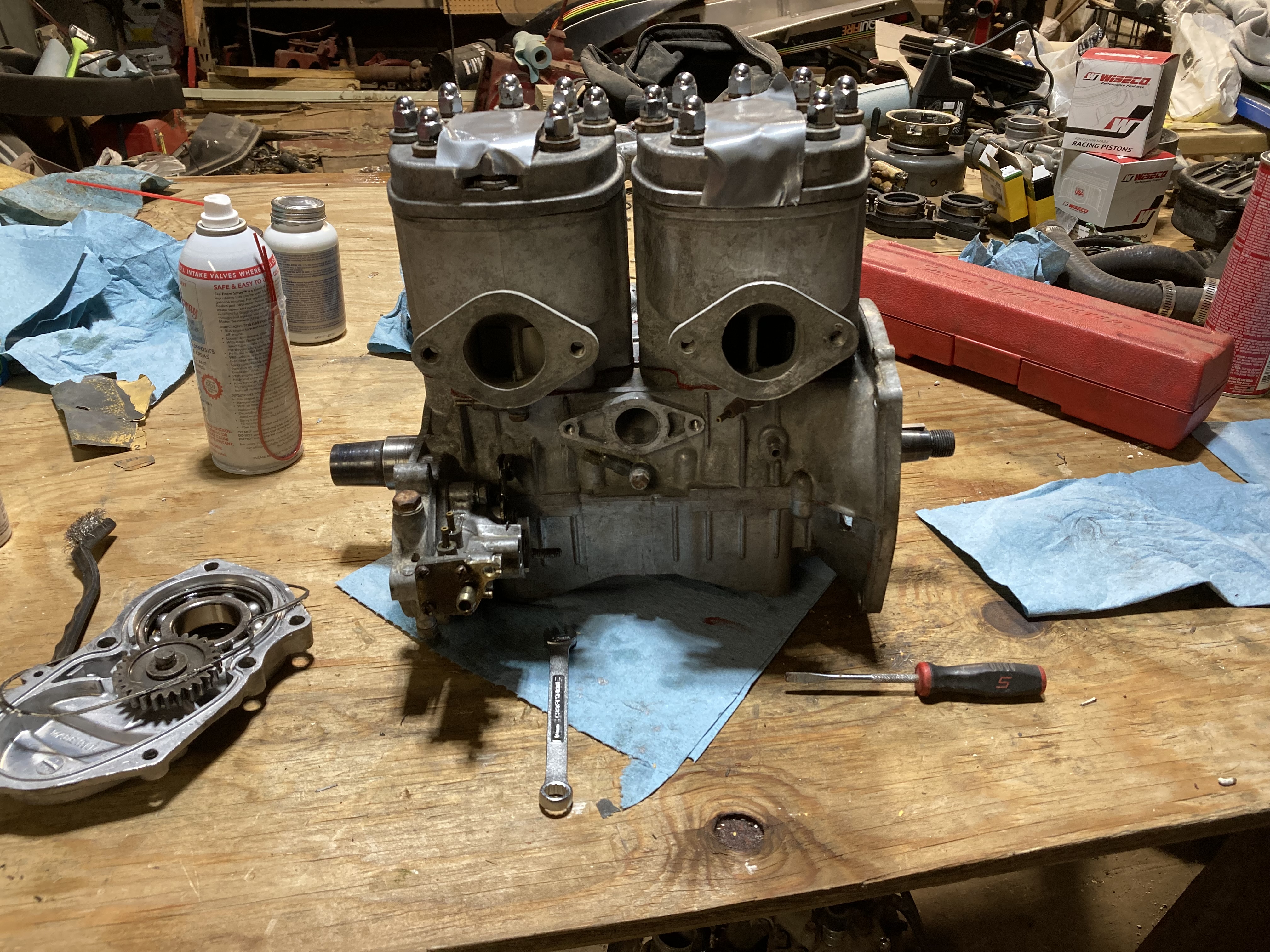

The engine is looking like an engine again! I installed the cylinders, heads, water manifold, and oil pump tonight.
Re: 1981 Liquifire restoration
Wow....good job. Just a question, I see orange sealant. Back in the late 90s I bought a tube of sealant from my Deere dealer. They followed the trail of substitution and it ended up being some orange stuff made by GE. Would this happen to be what you used?

It is red RTV. My dad is a John Deere salesman and he did some cross checking with the original part number and this is what it cross referenced to.
