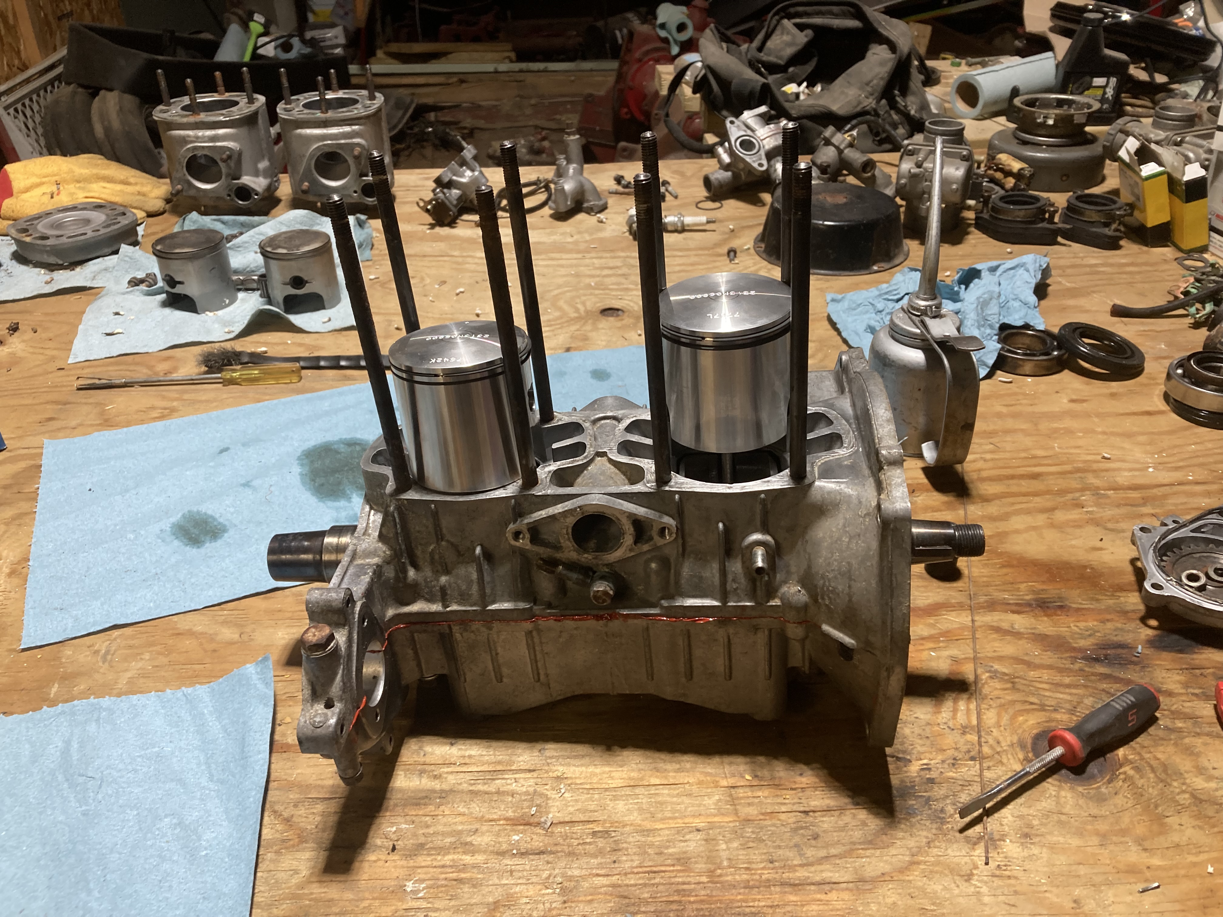

I got a little more work done on the liquifire today. The crankcase is back together and the new pistons are on.
My sandblasting did not go as planned because our air compressor is to small and couldn’t keep up. I am going to have to go to my grandpas sometime and use his air compressor to sandblast.
